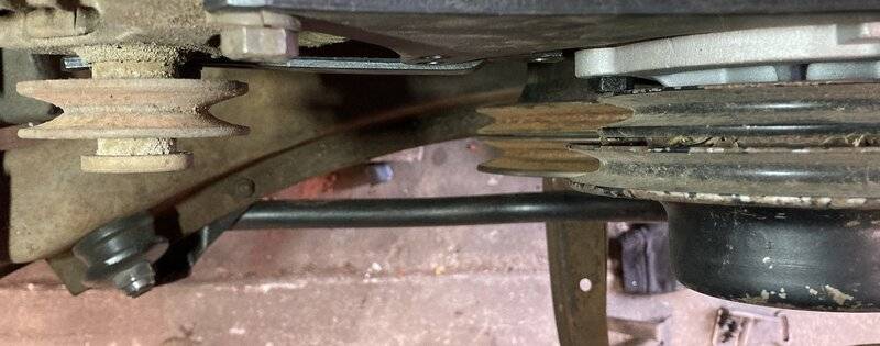

Hey all, I’m working on getting the accessories figured and it seems I need a double-groove water pump pulley for my 383 - I’m running alternator and power steering only. The single pulley on the alternator lines up with the inner pulley on the crank, the power steering lines up with the outer pulley on the crank. The dual groove pulley for the water pump that I have has a six inch outer pulley and a 5.5 inch inner pulley, but the inner pulley hits the water pump bolts. Maybe a dual groove water pump pulley with two six-inch diameter pulleys and use smaller water pump bolt heads?

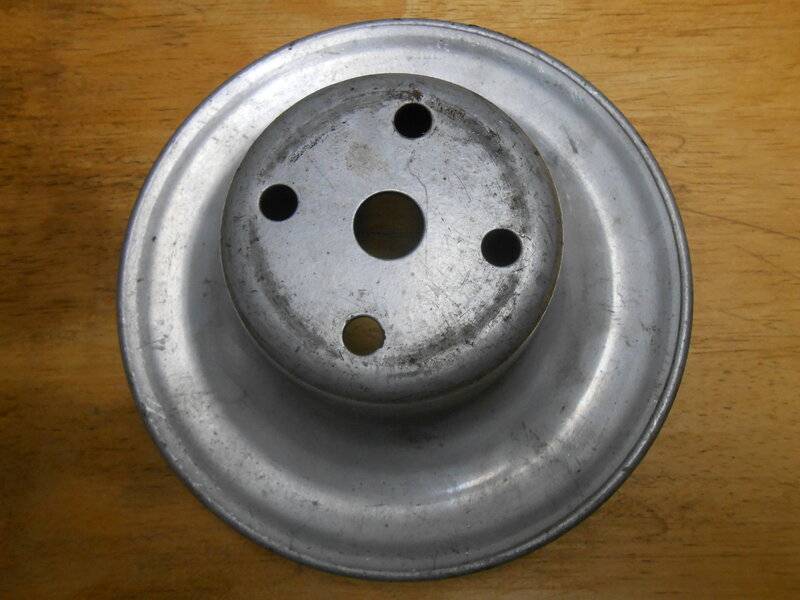

Got a clean original one. Will need blasted and painted as only the part seen was painted by someone inside still appears to be original paint.. $40 plus shipping.. Coast to coast would be $16 Med. Flat Rate box..

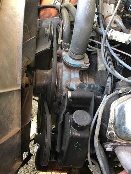

If this is a NON A/C car, the crank has 2 grooves but the fan pulley has one. The fan, alternator and crank share one belt, the P/S and crank is another belt.

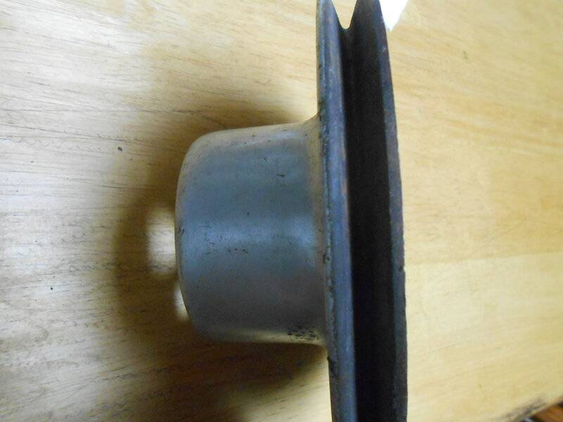

Yup the roadrunner has a single groove water pump pulley and a 2 groove crank pulley. Non AC..
This is the arrangement that I have seen on NON A/C cars with power steering.
Agree with Kerndog above....power steering runs directly to the crank pulley and the fan and alternator run to the water pump pulley and he crank pulley.

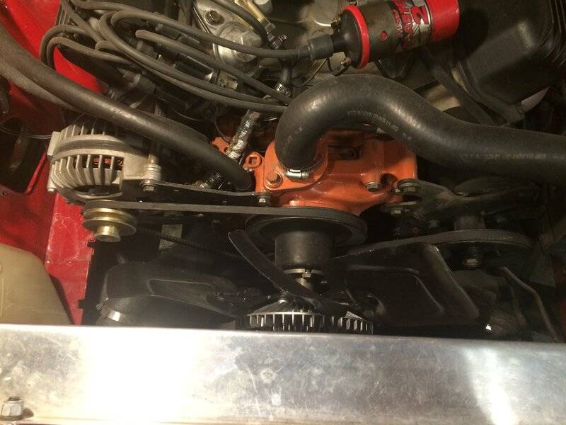

I happen to have a non A/C 383 that came originally with a 2 groove pulley. One is goes to the steering pump, the other to the Alternator. To the OP...I have a brand new on that is correct for a 383 that I will let go for very little as I need it gone. PM if interested...cr8crshr/Bill:thumbsup::thumbsup::thumbsup::usflag::usflag::usflag:

I should have provided more info: the engine is from a ‘64 Polara, and at some point, I also had another 383 from (I think) a 69 New Yorker and I’m not sure which set of pulleys I kept! My car was originally a 383 four barrel with A/C, but that’s irrelevant and I shouldn’t have mentioned it. My apologies.
I’m trying out a different two-groove pulley tomorrow, but the guy doesn’t think it will work with a two-groove crank pulley.

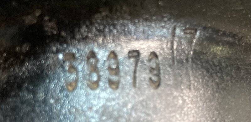

A friend dug through a pile of pulleys he had and came up with a winner! Mine on the left with the smaller diameter inner pulley that hit the water pump bolts and the new one with equal sized pulleys. Sure enough, the larger diameter inner pulley leaves enough room for the water pump bolts (440Source aluminum). The part number on the new pulley is 38979 and a really tall, skinny 17
