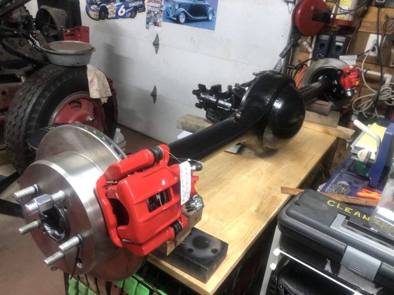

I just completed a rebuild of my 8.75 rear and a disc brake conversion, I just couldn’t believe how smooth it all went, holes matched up, and it’s spot on. If any of you folks are interested in doing a conversion I highly recommend Dr. Diff parts, you will not be disappointed.

View attachment 929935 I just completed a rebuild of my 8.75 rear and a disc brake conversion, I just couldn’t believe how smooth it all went, holes matched up, and it’s spot on. If any of you folks are interested in doing a conversion I highly recommend Dr. Diff parts, you will not be disappointed.

Don't forget to make a note of the 94-2004 Mustang Cobra brake pads if/when the new ones wear out. You will also need the special tool to screw in the piston before you can insert the new pads into the caliper.
You can get one on a loan-a-tool program at your local parts store or just buy one of these for $20 like I did.
