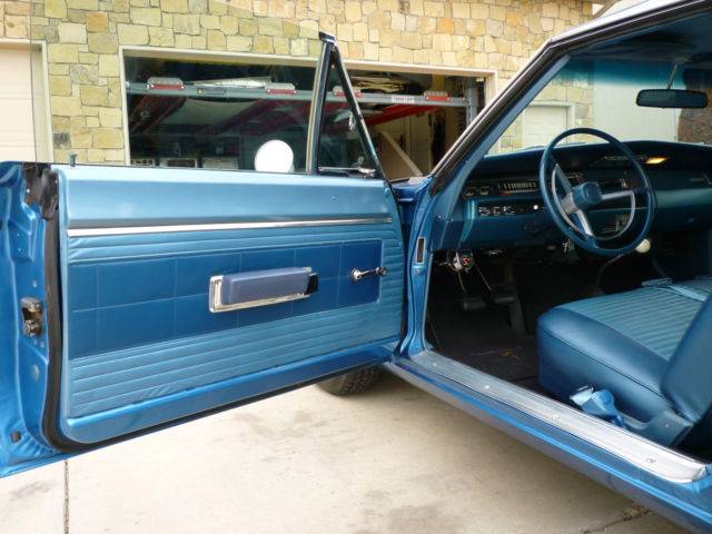

Anyone mess with a two tone blue interior on a 68 B body? I know the dark blue is "Baltic blue", but the light blue looks like B3. Can anyone confirm this? See the pic below for the color I have on my upper doors, headliner, and headliner and window metal trim. My interior is identical to the one shown in the below pic. I know this has been discussed before but it was never really narrowed down to the color I am trying to find and a color code.
Also, I tried Herbs light blue and it is way too bright for what I have on the original panels. It looks like 1970 bright B5 blue unless I got a bad can......anyone's input is appreciated as I am nearing my interior restore and need to get my ducks in a row. Thanks in advance guys!

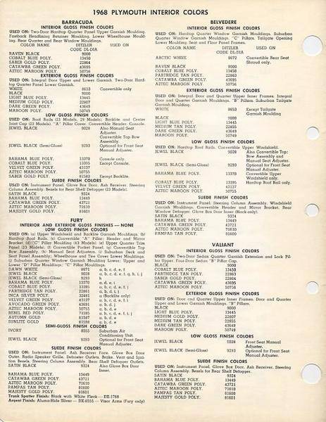

A 1968 didn’t use B3 or B5.
Likely the color you want is UU1 or just U.
