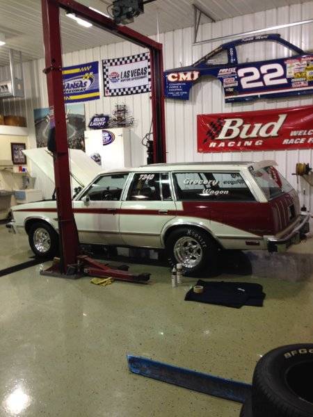

Yes, on my '79 Malibu Wagon drag car...air bags instead of shocks. 17 lbs. left rear 30 lbs. right rear. 1.48 60 ft.
