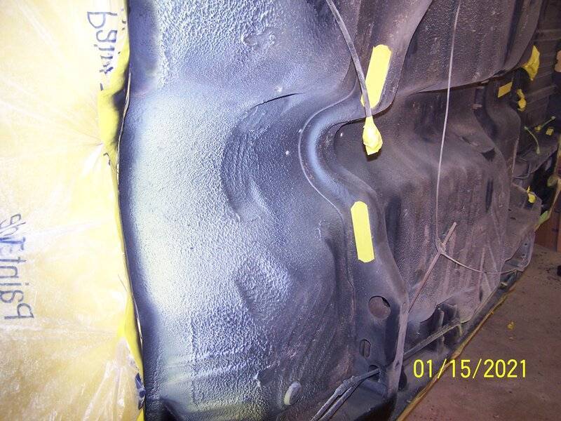

This what my factory undercoating on the RR looked like after 48 years. Here in Michigan, if it wasn't undercoated, the road salt would have eliminated most of the underside metal. This was a daily driver back in the day, nothing special at the time. Driven hard and put away wet 12 months a year. Only one small rust hole near the gas pedal (probably from the carpet being soaked with salt water for 4 months out the year).

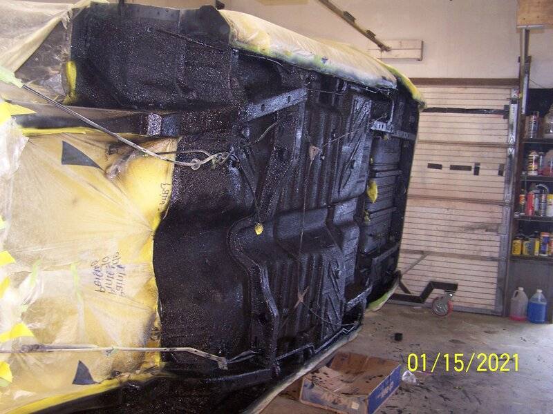

And this is what it looks like after a new application. It was a three part mix and then kevlar addition (for texture). Once dry it look like the factory job. I left some in the hopper and after it dried I pulled it out a hopper decoy!

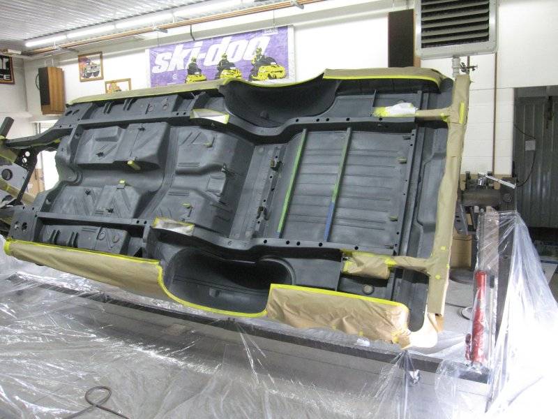

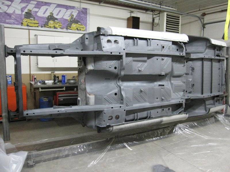

I had my GTX bottom blasted and did two things to make my brain not hurt! It was on a rotisserie,
so I mixed up some Epoxy primer and thinned it down with Acetone. I shot all of the areas where
the rails are spot welded to the floor pans with high air pressure and a narrow spray pattern. I then
sprayed the whole bottom with Epoxy primer, then paint. After paint, I thinned down some good
cosmoline and applied it to all of the rail to pan areas and let osmosis pull the stuff in to protect
the pinch welds. Done! Too much B.S., but hey, It's mine. Didn't cost me anything but the bill from
