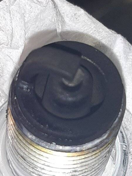

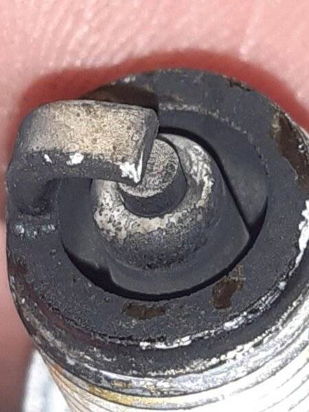

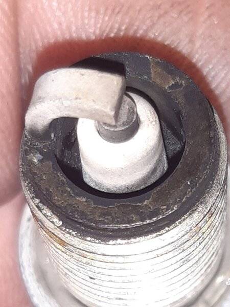

Hi! I have done alot of tuning with my Mopar 493 stroker engine, Edelbrock avs2 800cfm, Edelbrock rpm intale, Edelbrock E-Street heads 84cc, Comp cam xe275hl camshaft(231/237@050), 10,04:1 scr, Fbo distributor set at 18 initial and full manifold vacuum brings it to about 30 at idle, 34 degrees full mechanical advance. The engine running pretty good now with no hesitation or stumble, its just some slight misses at idle. I reading my spark plugs and they all looks good, except cylinder 5, 7 and 6 running richer than the others, is this about the rpm intake(dual plane) or what? The engine do not use any oil or anything like that and i have about 500 miles on it from new rebuild, i did a compression test a mounth ago and i have 200psi on all cylinders cold engine. The blackest one is number 7 and the 2 other rich ones are 5 and 6. The whitest plug is how the other 5 cylinders looks like. So the distribution must be uneven. Last time i checked it was number 6 that looked black like the 7 do now so it must be the distribution of fuel

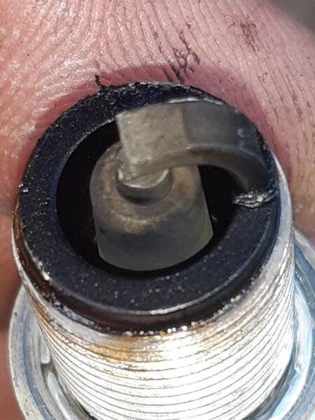

I don't mean to hi-jack this thread but just had a question about the spark plugs. I am running kind of a similar set up to the OP. My sparks plugs look about the same as the spark plug in the upper left pic. In years past I would have thought that was lean and they should be a tanish color. You can watch 10 videos on spark plugs and get 10 different views of what they should be. I was wondering what everyone thought about that spark plug in the upper left pic whether it is a good color or on the lean side.
Hi i wonder about the same thing and nobody seems to have a proper answer, im also running a wideband a/f gauge and that one tells me really rich but by reading the plugs the distibution is uneven, that means if someone just tuning by what a/f ratio gauge say its very possible its running rich or lean in some cylinders anyway and because nobody really dont know how to read the plugs it must be same playing on the lottery to just looking at a A/F gauge. If some of my plugs here really is on the lean side than leaning out the carb more just for make the A/F gauge happy just going to make those plugs even leaner, so it is like a lottery even with a A/F gauge if you not running 8 coils and 8 injectors, one mixture for each cylinder.
After another test drive it was number 6 that was totaly black instead of number 7 and still 3 fat cylinders so its not just a single one of them thats running fat so i belive the problem is and i have always belive it that it is the distribution of fuel in this intake that is uneven, maybe its just so that the dual rpm intake not working properly for my combo. Im going to try a street dominator intake, i know the single plane are better for distribution and are more forgiving in the low end on a stroker engine, if it is better for even distribution and i maybe have to give up a few lbs in the bottom end so let it be so, the bottom end is huge on this engine and im not a race driver so i belive im not even notice the different, the engine have more power than i ever use, i want the distribution even and the engine feeling well.

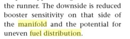

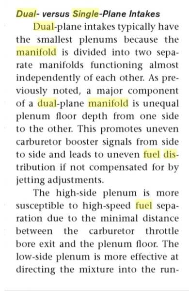

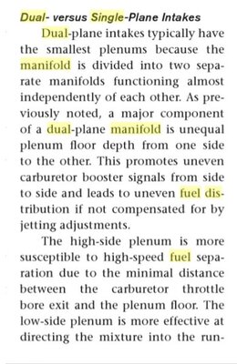

You have never heard about uneven fuel distribution depending on intake/engine combo? Ok than you maybe should try to study that topic some .Why do you think there is alot of different manifolds to fit the specific engine, dual, single and so on. I not believe it myself before i talked to some known engine builders about it and they put me into the topic more. You must have see sometime that one cylinder run leaner/richer than another and now im not talking about only WOT driving. A little reading here in the link, there is alot more about it in different forums and so on
