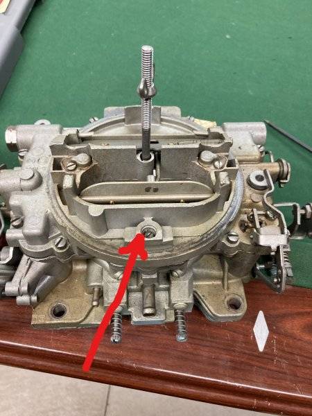

Can anyone tell me what this screw adjusts and how to adjust it?
Carb is a 4640 Carter AVS which I just purchased. I'm familiar with AVS carbs, but until now never knew there was an adjustment screw here that is typically capped off.

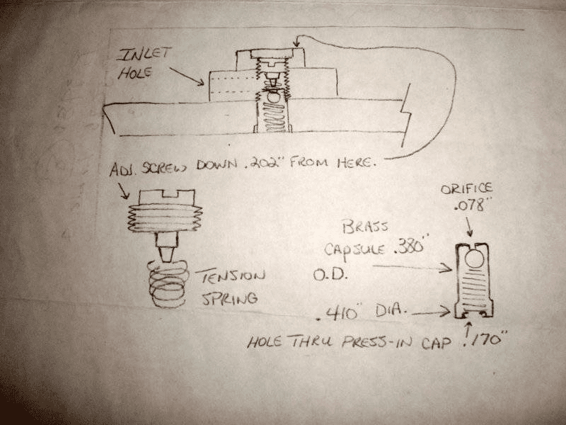

That controls a bleed that leans the carb off idle. It was factory set and capped. I found this years ago but can't validate it. You can find a lot of tops with this bleed removed and plugged.
What D.Slayer said...
That's some good info, thanks guys. I measured mine and he top of the screw is .180" down from the surface of the carb.
Not sure where to go from here. Think I'll start off leaving it where it is and see how the carb performs.
Any thoughts as to what symptoms I might see if it's too far in or out?
I do have another AVS carb with it blocked off, but its the smaller cfm version, wonder if might be adjusted the same?
Moving it in, will block the passage and less air goes into the idle/transistion slots when the spring and ball are exposed to vacuum. So that keeps mixture richer. If you move it out the needle exposes more port and more air can come in leaning the transition. I guess it would take an AF recorder to really appreciate what is happening if everything else on the carb is good.
The device was an adjustable air bleed that works on differential pressure in the off idle transition circuit. It was factory set during initial calibration and also functions during closed throttle deceleration to prevent rich mixture during coast down. It was part of an emission control system to prevent overly rich condition and high CO readings.....it also created an off idle stumble in some applications. Explained in Chrysler's service technician book #68-2.
