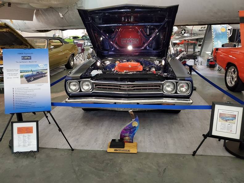

I thought I would update everyone on my journey so far.
So,, I have had my GTX for about 17 months (this one,, I did have one 48 years ago for about 2 years). In that time I have been able to get the older paint job to shine really nice and have touched up things where it was needed. I did have a body shop take some tiny rust spots out of the lower rear fender panels behind the rear wheels (below the chrome body strip in the black paint area) last January. When they had it in the shop, I had them do a through check on the car and they said there were no other patched areas in the body that they could see - all original sheet metal as far at they can tell. This confirmed my thoughts as well as I could not find any patches in the trunk, floor pans, or fender areas.
I have cleaned, painted, polished, replaced and installed parts as needed to make this a really nice survivor type of car. It is not a numbers matching car but it is period correct as far as I have found. In January and February I took the Carbs off for complete disassembly and rebuild, removed and painted the valve covers, removed the intake to clean and paint it, removed the oil pan to get a good visual inspection of the bottom end. The engine appeared to be newly rebuilt.
I have started looking at trying to find out more about the car. It would be nice to have more information on the history of the car. The older gentleman I purchased it from didn't have any information to pass on. All he could tell me was that he purchased it in 2014 from a guy in Nevada. It did have a front license plate surround from sierraclassics.com - Reno NV.
I attempted to contact them several times but did not receive any information back as to if they had sold the car at some point or had any history on it. I'll continue to try to trace the history back.
I did pay for a VIN search from one of the approved NMVTIS sites (VINData) and was able to see back to 2009.
I am the 2020 date one as that's when I went back and got my Collector personalized plates - MY69GTX
Title Issued Date State Type Event Reported Odometer Source
07/17/2020 - Minnesota - Current Title issued RS23L9G276470 - Exempt - NMVTIS
02/12/2014 - Wisconsin - Historical Title issued RS23L9G276470 - Exempt - NMVTIS
01/03/2011 - Nevada - Historical Title issued RS23L9G276470 - Exempt - NMVTIS
10/06/2009 - Nevada - Historical Title issued RS23L9G276470 - Exempt - NMVTIS
07/14/2009 - Nevada - Historical Title issued RS23L9G276470 - Exempt - NMVTIS
Over all the car runs fantastic. I have gotten a lot of attention at car shows and cruse-in's and have been luck enough to receive several plaques and 2 trophy's. It's so fun to talk to people at a show and hear their personal stories. Since I am pretty much done with shows and cruise in's for this fall,, I plan on using my time to again scan eBay, freshen up the look, install and change a few things, and get ready for next year!
So many shows,, so little time!
Verlyn
