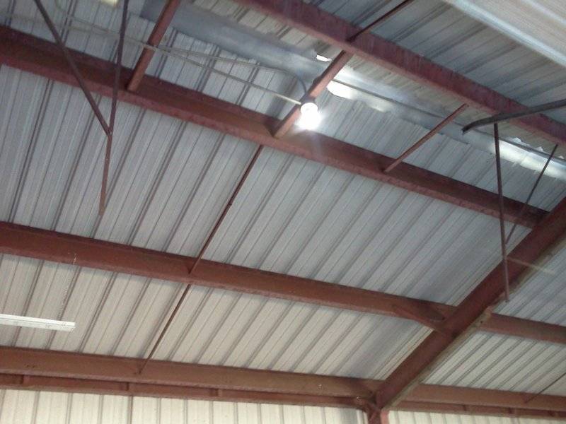

Took down this-

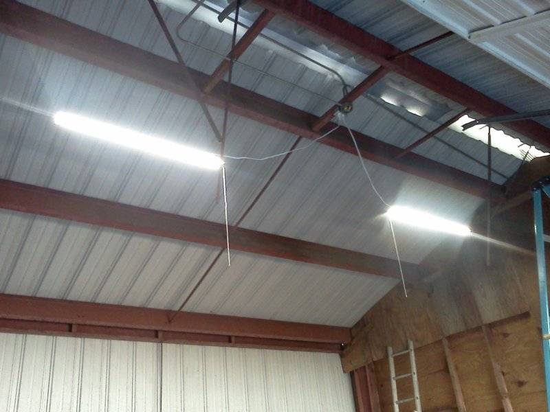

Added this-

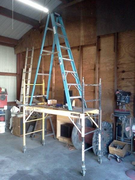

Hung these-
...using this contraption-

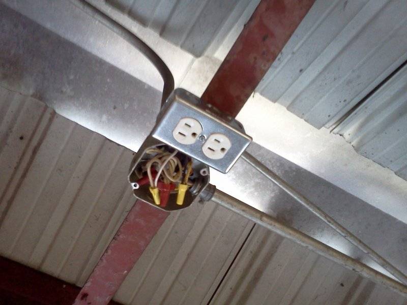

I'm also adding receptacles every 10 feet on two separate circuits (black and red dots).
As built, all four bays had ONE 15 amp circuit for all the lights and all the receptacles combined!
Normally I have it lashed together with 2 ratchet straps.
Then I can pull myself around without getting down.

That's crazy to only have 1 15 amp circuit in a garage! Lights look much, much better, what are they, LED?

They are 4500 lumen 4' LED fixtures from Rural King.
Right now, 2 per bay but I had planned 4 per bay.
They are replacing 1 per bay 800 lumen CFL which replaced a 60w incandescent.

The left receps in my boxes are on the black leg of the panel, the right ones are on the red leg.
Interesting idea about 20A 240. I had a 20A 240V compressor that had a 30' cord with a cap that looked like a 20A 120V plug but the sideways prong was on the other side.
The NEC requires 20 amp circuit GFCI protected outlets in each garage bay as of 2017.
