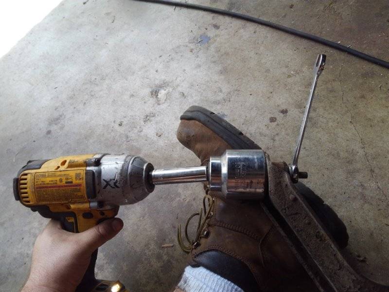

Ok guys this is mostly for the young guys or the new guys to the Mopar world .
I've spent many an hour beating bushings in and out !
So here's the easy poor man way . You don't need these exact tools a piece of metal pipe will work or something in scrap pile?
So I took pictures

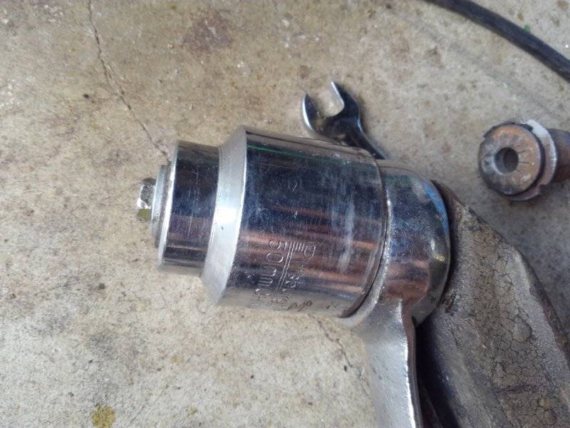

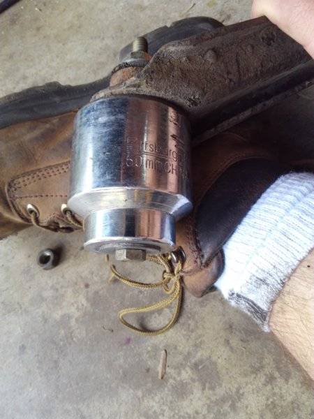

Basically sockets gos over the out side edge over the fat side!

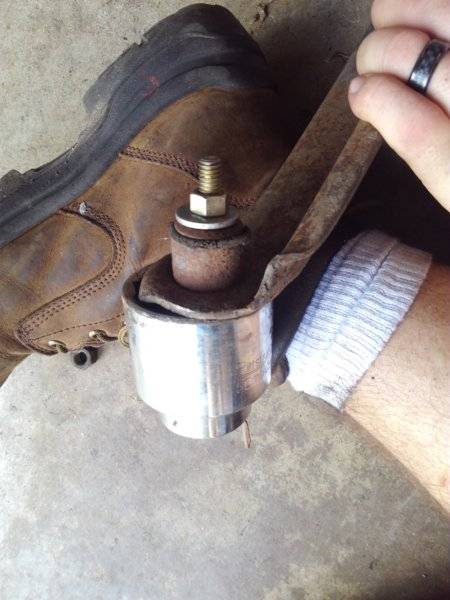

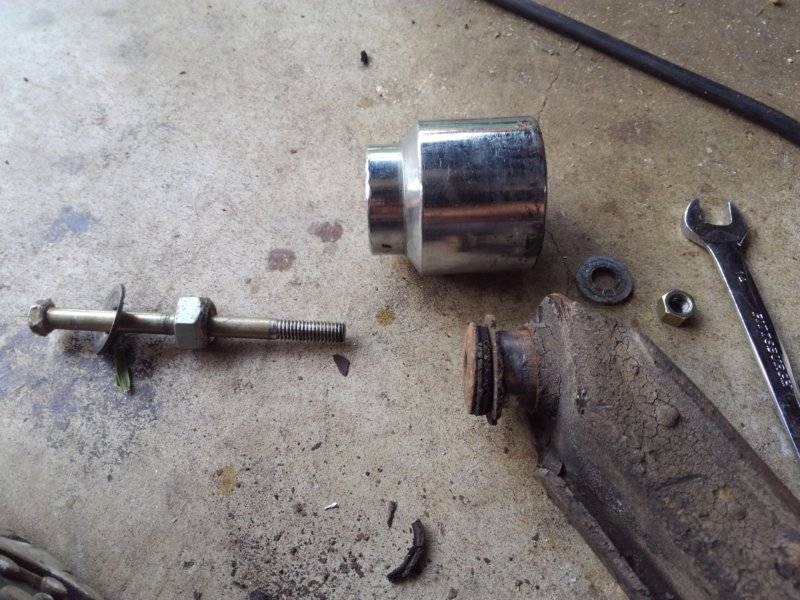

Run your bolt threw socket and nut it under bushing then just impact it out remember the bushings will start to rise in socket area so you will need to give enough room for them to move in or you'll bottom out.
I added a big wench under socket to make up room !
Easy right guess what just reverse process put socket on other side and in they go !

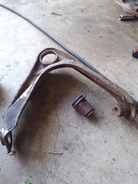

I have out picture s I'll get in picture s when I get control arms clean and painted
Hopefully this helps someone!
