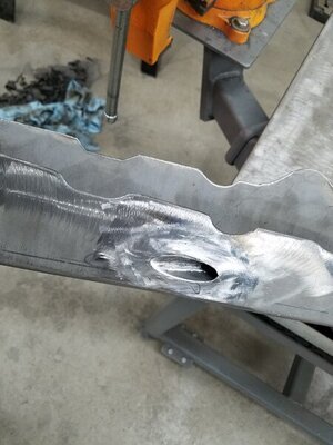

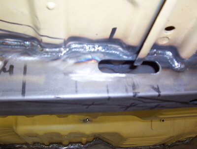

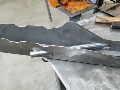

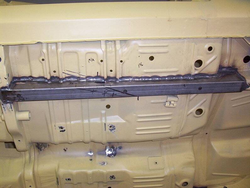

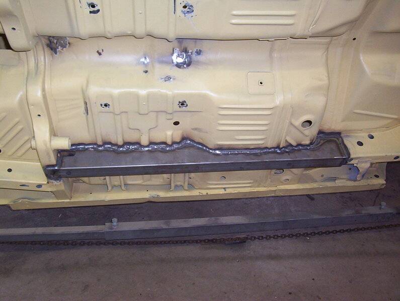

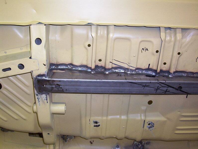

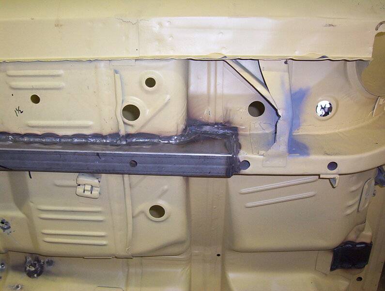

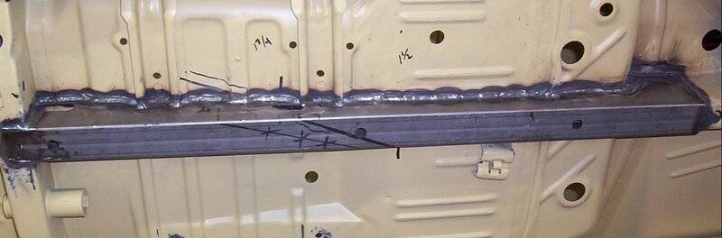

I put them in my 69 Charger. For the emergency brake I cut slots so the cable could pass through. As far as fuel and brake lines there is no problems. Just make sure yours are good or replace them before you put the connectors in. My car was a stripped right down to a bare shell on a rotisserie. Once I had them fitted I put the car on jack stands and tacked them in place. Then I lifted it off the stands and flipped it as needed for best welding position.

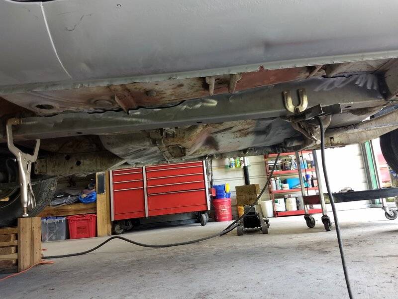

I had a set installed on my 1964 Polara. The welder that did the job supported the car under the front lower control arms and under the rear axle tubes, so the weight of the car was on the suspension, as it would be if the car was sitting on its tires. On our early b-bodies, these connectors do not interfere with brake or fuel lines, or emergency brake cables. They are a nice addition that adds quite a bit of strength to the structure. When welded to the floor, this becomes a boxed frame rail. My car is a 4-door hardtop, and I thought this addition would make up for not having the structure of a b-post running up to roof.

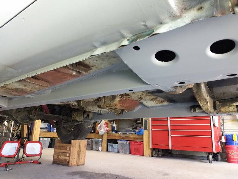

Here's a set finished. All lines fit well...
I installed a set on my 65....I had car on suspension,welded them fully to the floor...there are a couple places I had to "fit"them... Alot of the "fitting" can be done with a buddy inside with a body hammer!
I dont have Ebrake cables and lines run yet but dont think there will be an issue...of course factory brake and fuel lines run along rockers...although I was considering rerouting mine now that I have a "full frame" The only caution I would offer ... Be sure to watch your welding heat... Weld short sections and move around. ;

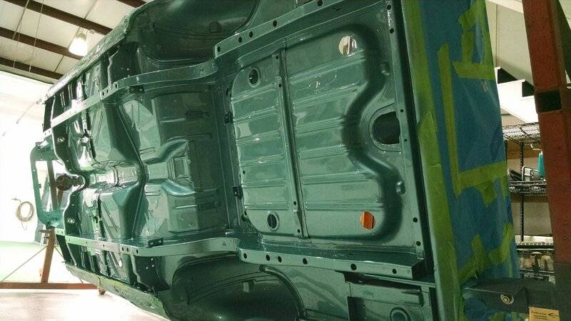

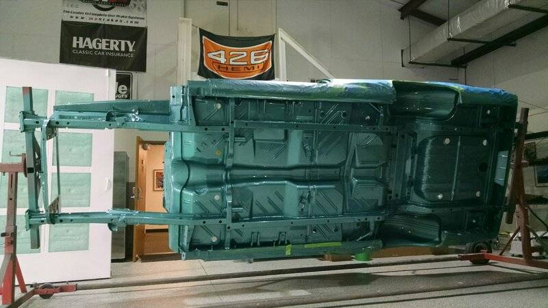

It is just reference photos that I am doing on my project.
Just giving you a hard time for posting pics of my garage, lol. That is the thing I like best about this site, seeing how others have done things and incorporate that into my one cars.

Your picture shows a tube through the connector for emergency brake cable. Is the car a 65 or another year?

I will be doing this on my 68 Charger. Hunt2elk, posted them from his garage awhile back. I’m not sure what year or model.

69 Super Bee. Never had a 65, so don't know if the e-brake cable routing is the same?
