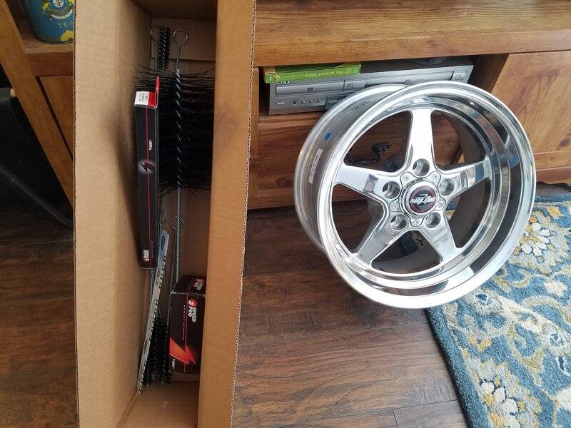

Well after further investigation and the fact that I went ahead and ordered a set of race star 92 series wheels, I called them back and they make both unilug and direct drilled made to fit ,but my order was already shipped and I liked these wheels also and 17lbs lighter
to my surprise Fed Ex just called and told me that my shipment was at the top of my drive and he wouldn't have made it except my neighbor was out with his 4wd kubota and drug him through the drifts at the end of the road. He didn't want to come down the drive!Hey cool got my wheels and few other things to put my 440 together! Front wheels only the rears are being shipped directly from suppliers.
