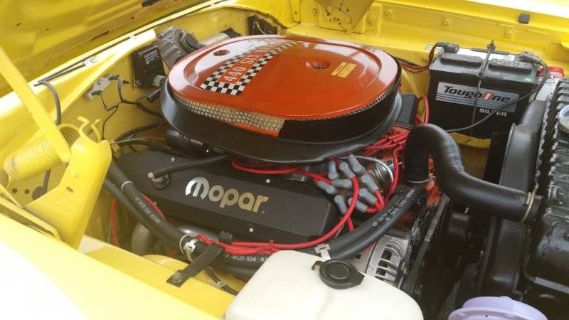

hemi orange with hood black out
a black rear stripe
440 six pack
4 speed
air grabber car

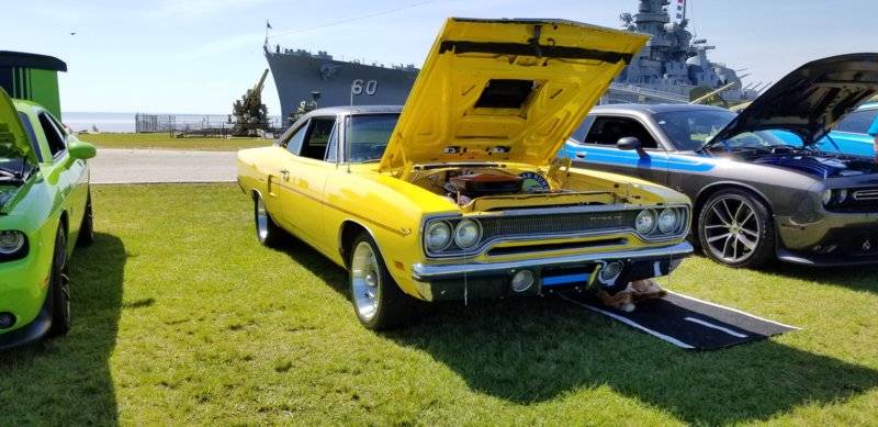

nice!
I'm a bit jealous.
Let's see the car!
