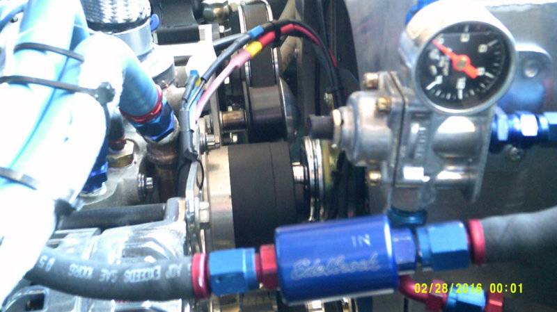

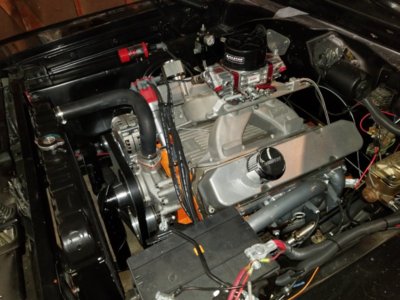

sorry the photos aren't very good,
I didn't take any photos of it with out the other stuff already mounted
it's a tight fit too, custom rad & shroud, Perma-cool 3500cfm 16" electric fan
35gpm elect. Proform water pump
& the idler etc.

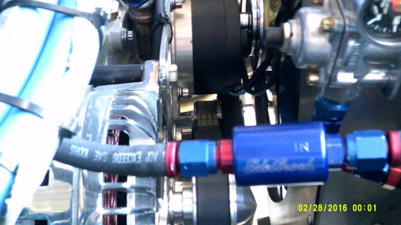

this is the alt. belt & going down to the back slot of the crank pulley

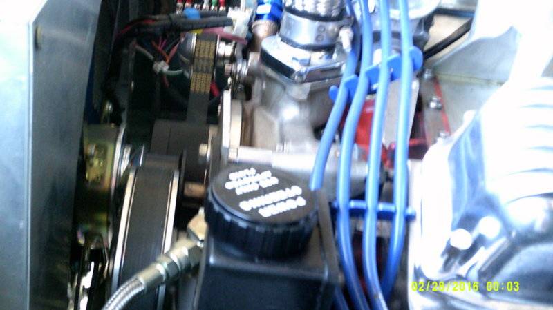

you can sort of see the idler set up, mounted off the water pump,
plate 7075 alum. .250", with a spacer & the idler pulley
to keep the PS pump belt away from the electric water pump, more belt/pulley contact too
my car is sort of a drag car in search of a corner, I wanted PS, where I live, in the sticks
68 RR #37 Power Steering Pump for Unisteer rack & pinion serpintine belt ds.JPG
& the idler etc.

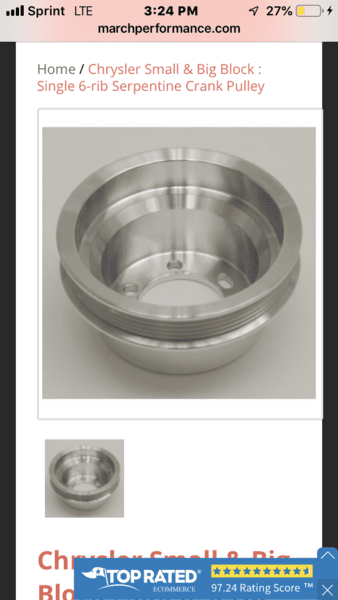

I was looking at the March pulleys, alternator and crank only and just route it like that, I don’t think I would need a idler, right? It’s up in the air I’m still working on the car and collecting parts so just something I’ve been thinking about.
Looking again I’m only seeing a double groove crank pulley, I would only need single groove of running just the alternator on it.
"I'm pretty sure", they make single belt serpentine crank pulleys
I may be wrong...

Thanks bud, I see the single belt one now lol. :fool:

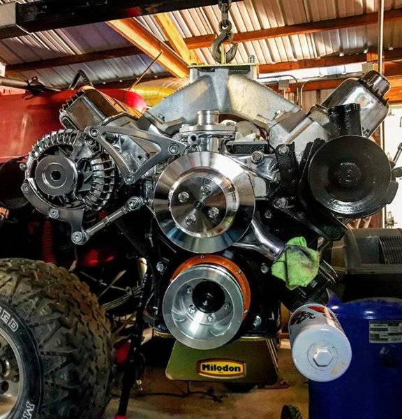

In the picture, at about the 2 o’clock position that hole is oval. What’s up with that? My billet 440 source pulley has that also.
I'd have to look "don't quote me"
but I think my March Ind. dual v-belt pulley
(I had before, the serpentine, I have a set of reduction/dual crank
& single "chrome" steel alt. & single alum. water-pump, still if anyone needs them,
for alum. crank & wp pulleys never ran, if interested PM contact me
had that oval-ed hole too
I think it's for some cranks have an offset bolt pattern
I can't remember which or why
but IIRC it make them more universal fit
