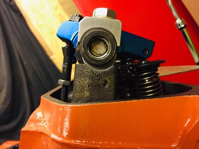

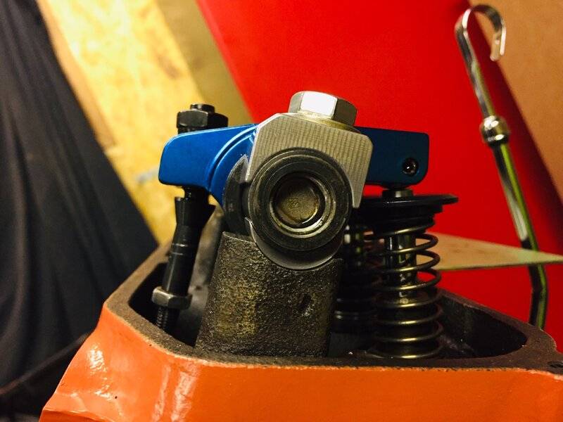

See mine when i worked on the rocker geometry, at the closed and full lift position.
Many combinations can result in many different angles, but this is where it should be.

View attachment 1283710 View attachment 1283711
I’m doing pics on Sunday but see how the angle is on your rod to rock on your valve open. That’s kinda what I got going on when closed.
