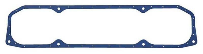

Moroso Permalign gaskets. One and done.
I’ve heard those work with aluminum heads and not so much stock cast ones?

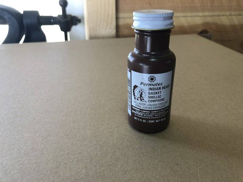

OK, just went through this on my 71 440 when installing the new AMD repro valve covers. I tried several different gaskets. Tried the silicone, cosmetic, And FelPro 1610. None sealed in the rear corners. Ugh, what a mess. Finally the FelPro 1612 gaskets are working but also used Indian Head gasket sealant between the VC and gaskets. Also found out the equal torque on all bolts/ studs is critical. Also the gaskets are thicker than stock ones. So be careful with bolt thread engagement.......just saying.

OK, just went through this on my 71 440 when installing the new AMD repro valve covers. I tried several different gaskets. Tried the silicone, cosmetic, And FelPro 1610. None sealed in the rear corners. Ugh, what a mess. Finally the FelPro 1612 gaskets are working but also used Indian Head gasket sealant between the VC and gaskets. Also found out the equal torque on all bolts/ studs is critical. Also the gaskets are thicker than stock ones. So be careful with bolt thread engagement.......just saying. View attachment 993583

Indian head, been using over 45 years !!
I used the Moroso with cast heads and factory valve covers. No leaks may have just been dumb luck but 2 times I'd say its more than a fluke.

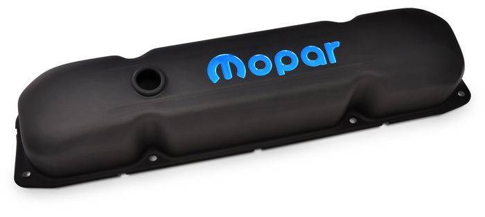

I know you are talking to the OP but I have installed 3 sets total and the first ones were on Mopar Performance valve covers and cast heads.. Forgot about those.
