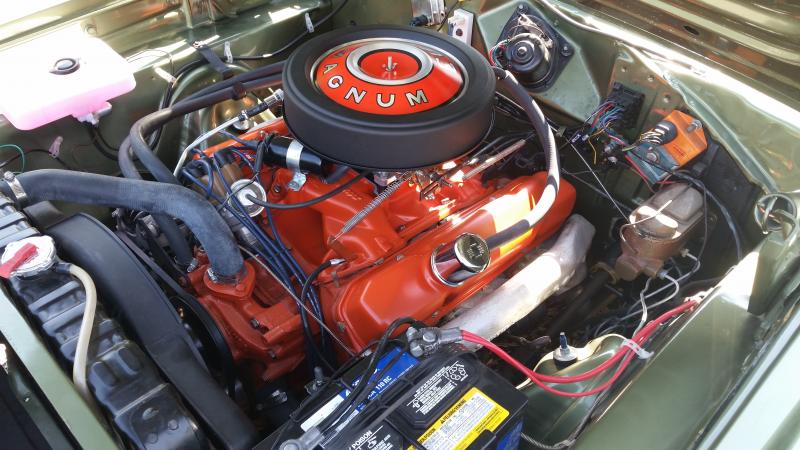

I sandblasted my valve covers and shot them with the original blue mopar paint. no primer and they looked amazing. still look great 2 years later.
first coat was thin layer then went thicker until i hit 6 coats.
The other guys might have a different opinion this is just my experience.
