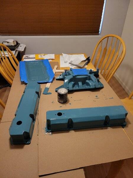

For the PCV valve, you will need to install a baffles to keep excess oil from being drawn out. A piece of rigid sheet metal about 5-6" long and as wide as the inside of the valve cover. Once you cut your hole for the PCV valve, install grommet and valve. Measure how far inside the valve cover it sticks. Get aluminum spacers about 1/4-3/8 thicker than that distance. Then drill 2 holes on opposite ends spaced where you think it will look OK. I used 1/4 × 20 machine screws. You can see the holes I drilled in mine. With a dab of silicone, no leaks at all. I dont have a pic of the inside. I used stainless button head screws and nylock nuts.
