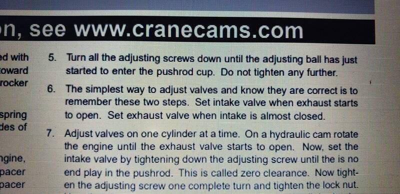

Depending on the cam TDC might not put it on the base circle. Adjust intake when the exh starts to open. Adjust exh when intake starts to close.

EOIC method is my prefered way to do it, but I have a built in starter bump button that I plug in when I need to rotate engine and makes it very easy. Dont even need the key to be on. They make clip on one that attaches to the starter also.
Exhaust starts to open, adjust the intake valve; Intake just closes, adjust the exhaust valve. Adjust the screw to remove all of the lash in the pushrod, then turn another 1/2 to 3/4 turn and tighten jam nut.
