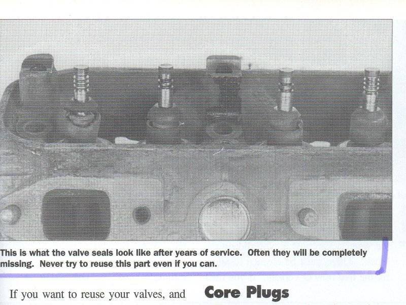

The pic above: Valve has 4 grooves, mine have 2 grooves.
The old seals from my engine are hard, but not damaged.
I should have paid more attention when I removed them, but will be checking them closely real soon.
