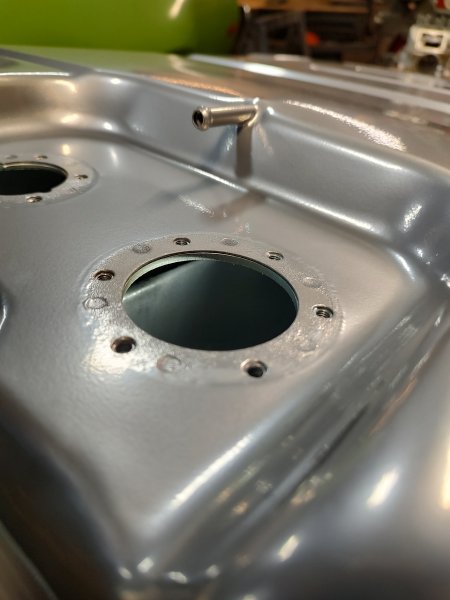

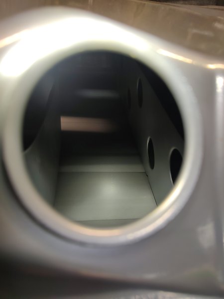

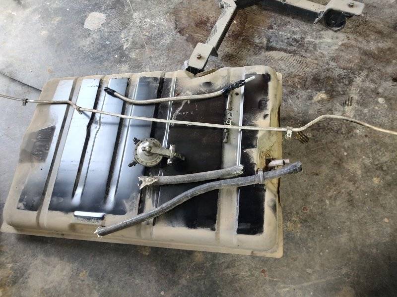

First off here's why I went with the Tanks Inc tank vs just modding a tank, the baffling is pretty impressive! there's literally a sizeable tub that the pump sits in then a baffle just behind it, absolutely no way your starving the pump on acceleration.

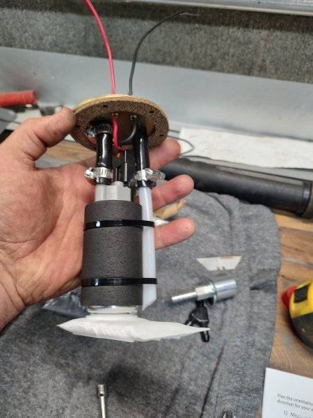

Putting the pump and sending unit assembly together are pretty straight forward using the instructions. Only advice I'd add to it is this pump is a tight fit, tight enough that it matters how you install the supplied zip ties as shown in the pictures. Same goes for the sending unit, unless you really trim all the excess float arm off it isn't going in the hole. I tested the sending unit for accuracy before installing it in the tank, looks perfect.:thumbsup:
Made in the USA!
Zip ties need to end on the sides for easy install.

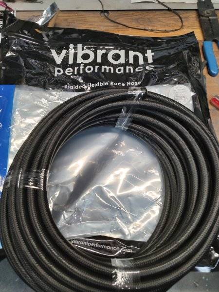

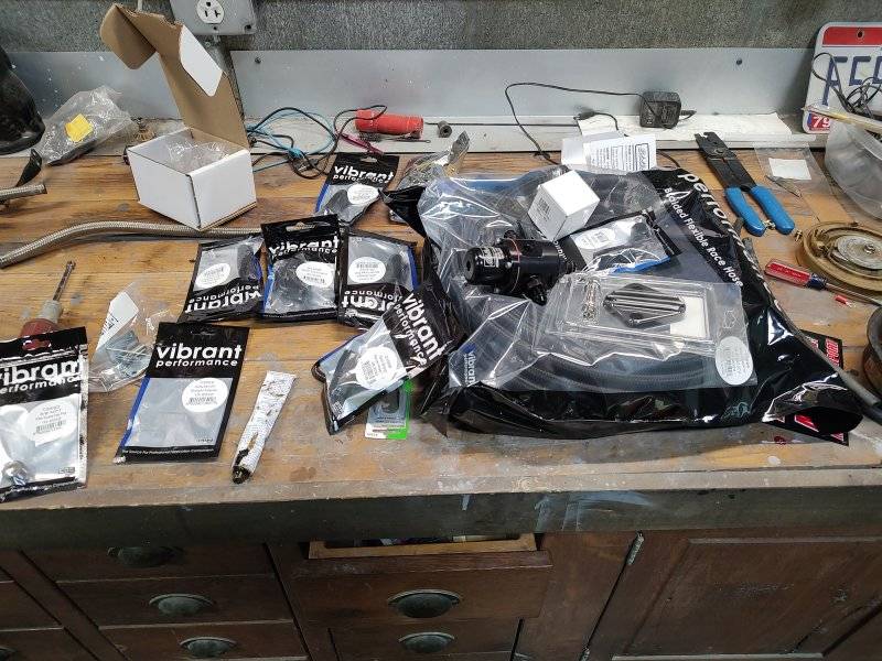

Parts run to Summit yesterday, should be set now! I was going to hard-line the fuel lines until I got under there and realized it was impossible to run them the way I wanted without splices so braided hose it is. Never used this type of hose until now but really like it, easy to work with and looks better than the braided stainless to me.
Nothing to add other than that type of braided line is a lot easier to work with than stainless braided line...

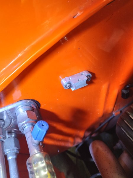

Gotta love the brackets provided, don't know how they expect you to bolt this to anything? Made a little aluminum bracket bolted to the firewall will rivet nuts.

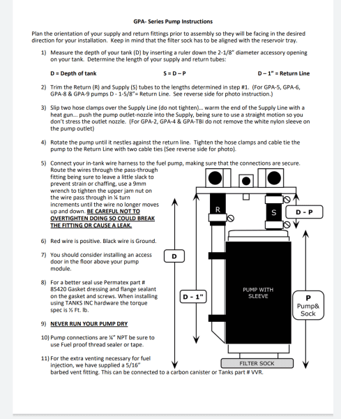

I'll post some useful info (a link) and the instructions here so anyone that's curious can see how simple it is to setup. When ordering the correct pump for a carburated engine it's important to read and look a the flow charts, EFI operates at higher pressures, the higher the pressure requirements the lower the gph. In simple terms these pumps create a lot more flow at 5-7psi.
Choosing the Correct Fuel PumpChoosing the Correct Fuel Pump
I like the size of the fuel basket they put in there. The pictures on their site are deceiving.

That tank and parts looks identical to the Holley tank I purchased a few years ago. Tanks, Inc probably makes them.
I will say the Walbro 255lph pump started to crap out on mine. Replaced it with a Walbro 450lph and no issues since. The tank is very nice.
