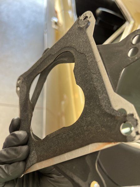

Do you have a factory vapor separator setup in it? My car does and it never stalled, but had a low speed and idle surge when everything got fully soaked. I found a silly thin spacer that hid under the gasket. I think it actually held in heat. Once I added a 3/8 spacer my problems disappeared. Before that, I was adding race gas with no difference.

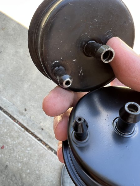

there are two versions of the factory separator going around. Be sure yours has the smaller orfice that is .060 and not the monster sized one that will lower fuel pressure.

Too much bypassing meaning low fuel psi? If so, it’s due to the incorrect orfice separator like in my pic. My car runs just fine when fully heat soaked, including starting, with the proper sized one.

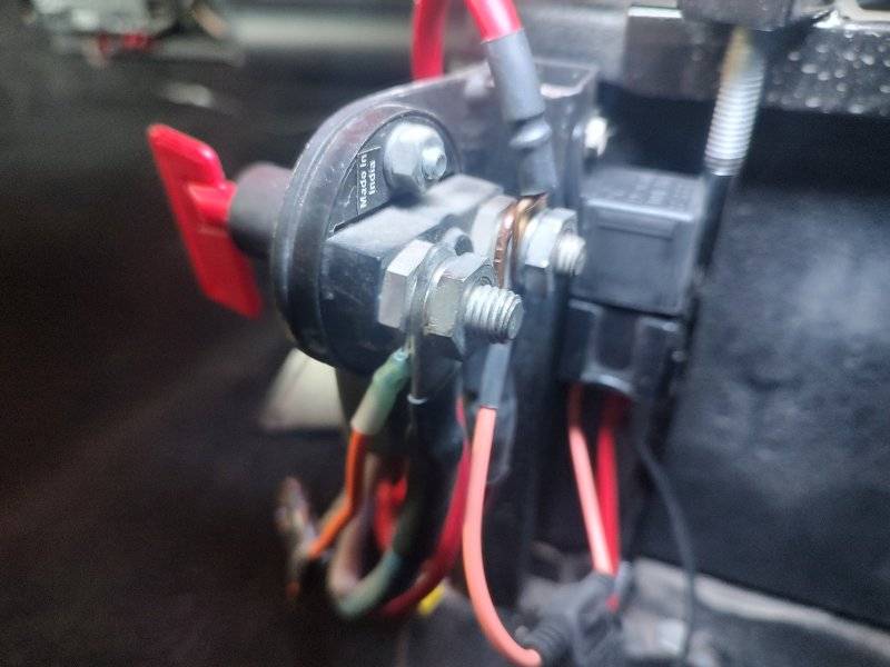

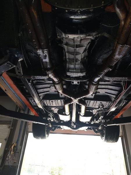

She runs again!! Time to start racking up the miles and see what happens. A few more pictures..
The lines tend to come out where the pumpkin could make contact so I made this little bracket that bolts into a few unused holes in the shock cross member.
Since I have a trunk mounted battery and a bracket for the battery disconnect it seemed like a no brained to mount the really right there.
All cleaned up!
