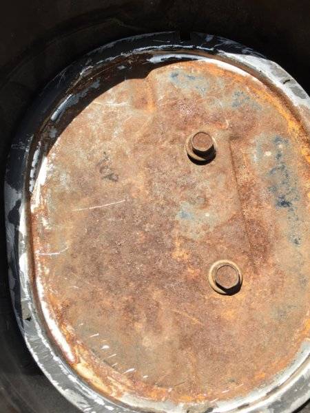

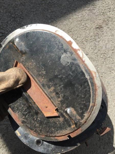

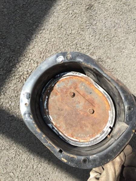

I have pics.
You can see it was around the edge, on both sides.

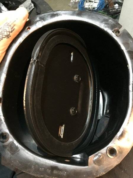

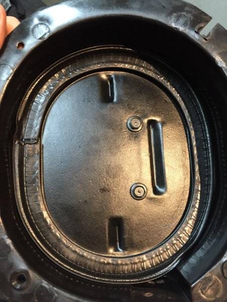

I ended up using a regular clip-on seal profile glued around the door. Seals up the vent box perfectly, better than original.

I can't recall what the name of the profile was atm. I bought it at a rubber, hose & seal supplier store.
It was a reinforced rubber U shape with some soft type foam sealer onit that seals against the plastic vent box.
Will try to find it when I am back home and take some pics.

My driver side vent box only seemed to have the one side of the flapper painted black (side inside the box). I see you painted both sides black. What is correct from factory?
Also, what glue did you use to hold the seal on?
I'm using the original seal but need to reapply glue/adhesive.

sorry, didn't spend a lot time online these days..
My flapper was definitely painted semi-gloss black on both sides. Only the pivot and the stamped sheet metal piece had a natural finish. The two bolts were black phosphate.
I used trim adhesive for the seal, works great.
