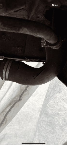

Are these vents or part of the filler tube? This one has seen better days and is cracking. Should I be concerned with changing them? Year One is saying there are two.
The small elbows are on the vent tube, and there are two. The big one is on the filler tube.
So I’m guessing what I showed is part of the filler tune and not the vent? It has some dry rot, I am going to replace it.
The one in the center of your picture is the filler, it is approximately 2" inside diameter.
