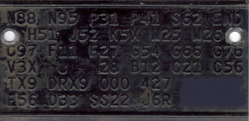

I went to see the car. It has a 360 2bbl. According to what I could decode from the fender tag it has an 'A999' transmission, I guess that is a "medium duty" verses the "heavy duty" 727.
