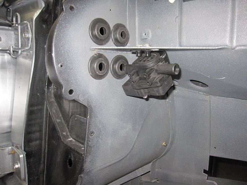

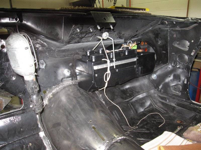

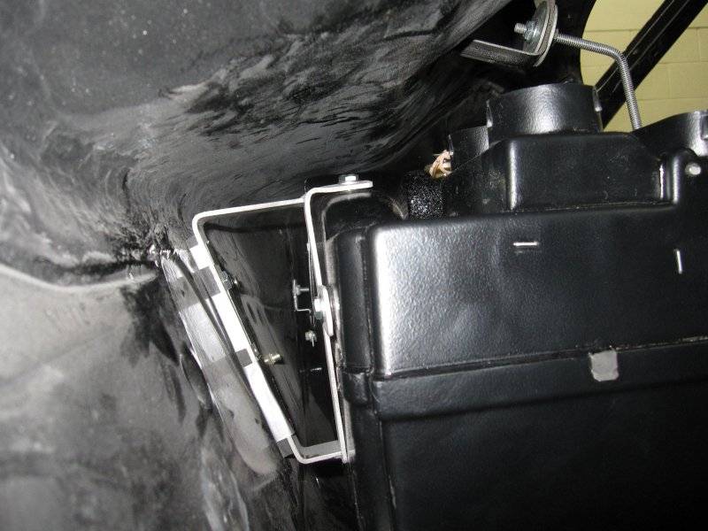

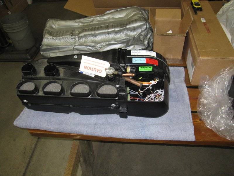

VA offers empty evaporator units just for mock up. I put a VA set up in my 65 Belvedere. I was going to use the 4 outlet model but, due to my enlarged tunnel I had to switch to the small 3 outlet model. With a stock tunnel the 4 outlet will fit. I built a plate to block off the fresh air opening for the stock heater and used bulk head fittings in the plate for installation ease. I also purchased the " you build it" hose setup. Works nice. Still under construction.
Mike
Mike,Looking at that photo,you are installing the heater control valve under the dash and not in the engine compartment. Correct ?
I ask because I'm not sure where to put mine.I was planing the engine compartment till I saw the photo.
That looks like it is up in the passenger front fender well to me. That is how Vintage Air does it in their kits available for later B-bodies. All the AC and heater lines run out of engine compartment through the inspection hole on the right. This did not appeal to me, so I devised another way to do it. That is the front shock mount hole just ahead of the water valve.
Here is how I did my water shut-off valve. I keeps the hot water heat out of the cabin. I did not have room to plumb it inside, anyway.
