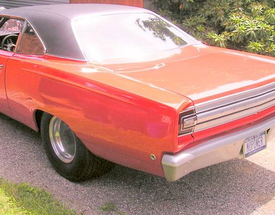

Put the top back on, I put a new vinyl on my 68 road runner myself, was not hard to do was easier to do with the glass out. had to replace a bunch of the trim molding clips. good razor, heat gun, tape measure, 3M weather strip adhesive in the can. one replacement vinyl top from year one.

Put the top back on, I put a new vinyl on my 68 road runner myself, was not hard to do was easier to do with the glass out. had to replace a bunch of the trim molding clips. good razor, heat gun, tape measure, 3M weather strip adhesive in the can. one replacement vinyl top from year one.View attachment 624511
