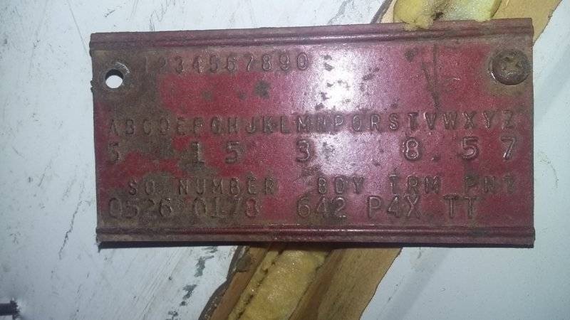

your car wouldn't happen to be mono tone dark red metallic which is pnt-tt on fender tag.vinyl top is x5 on fender tag
Yes it is dark red met. I will look for the X5
Yup, It has a 5 under the X would you happen to know what any of the other codes mean?
m3 backup lights,bdy642 dodge fleet8 polara 500,2door hardtop,trm p4x . prem. buckets,vinyl black. all i know

ould you happen to Know engine size from the tag? Mine didn't come with an engine when I bought it. I know it was a big block and assumed it was a 383.
thanks
