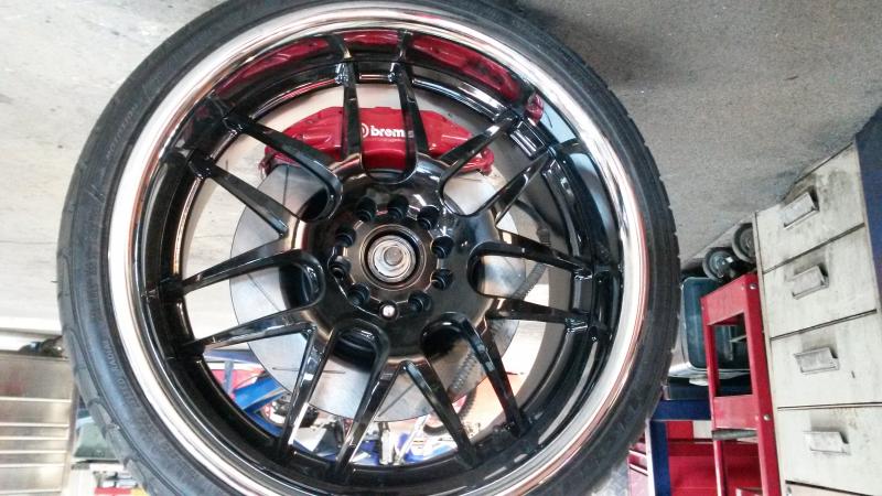

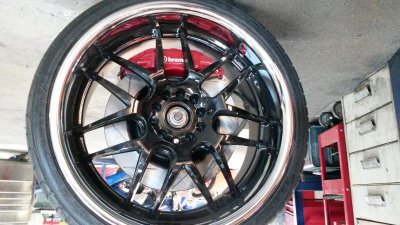

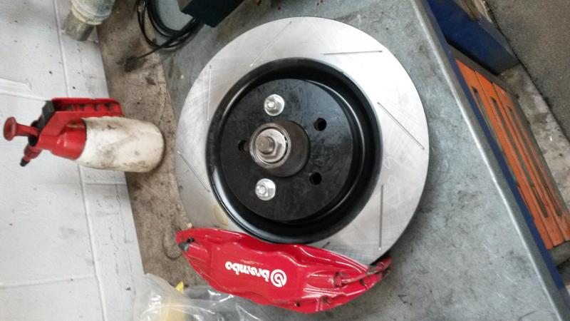

Doing a brembo caliper on mine at the moment. Very similar caliper, mine are off an Mitsubishi Evo X . I am using Magnum drop spindles and utilizing the drum hubs. Have machined out the hub to fit a seal that suits the bigger spindle and changed the inner bearing to suit. I am using a floating 14" disc rotor but you could use any size you desire. I will be making a custom caliper bracket shortly but have mocked it up with some flat steel and spacers to get offset etc. Big job but if you are handy at engineering it is entirely achievable. Sorry for the average photo uploads.
