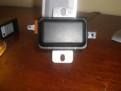

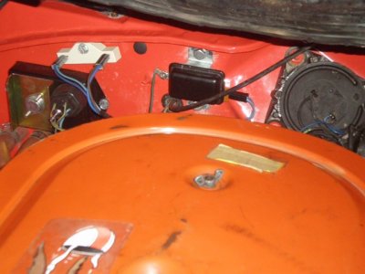

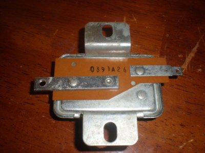

I only run these not and they are great , no more crazy extreme needle bouncing of the gauge
