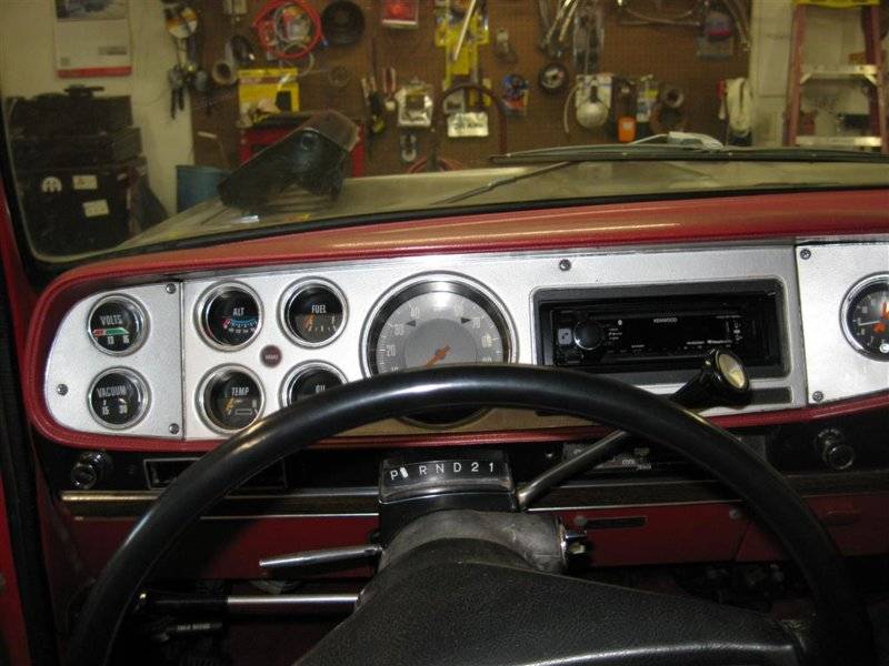

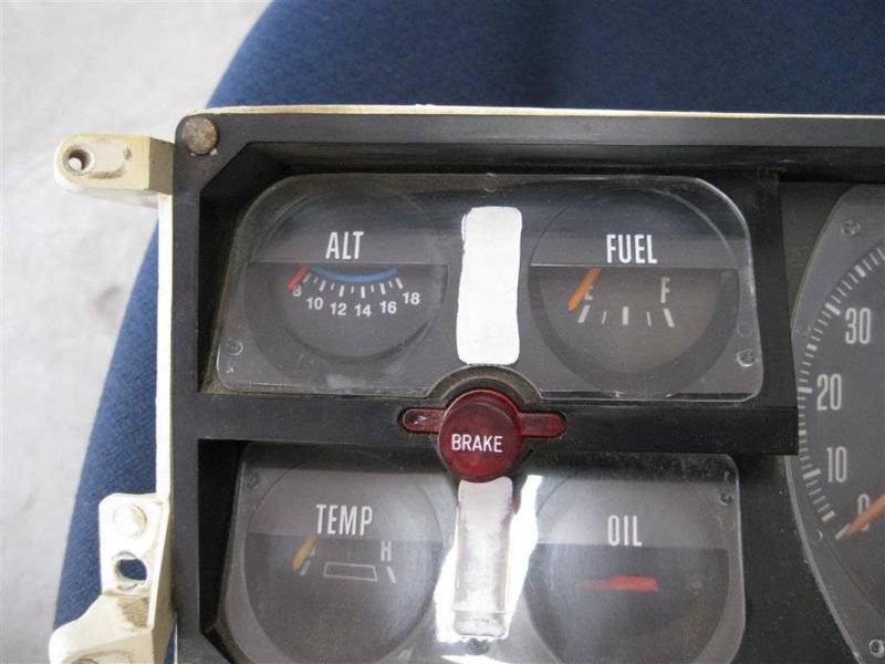

When you say upside down do you mean it points down? If so I used one of these in my truck.
https://www.amazon.com/gp/product/B00029JZXM/ref=ppx_yo_dt_b_asin_title_o00_s00?ie=UTF8&psc=1
I removed the guts and it lined right with the ammeter studs.
I plan on using the same gauge on my 71 Charger rallye gauges. It works for the tach/clock gauges but not the standard rallye gauges.
