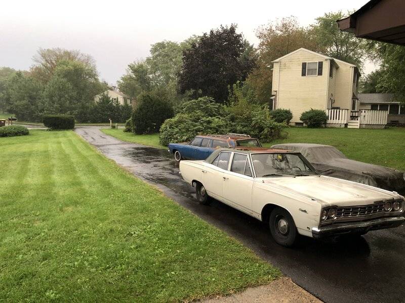

Here’s a pic of my 4 door and wagon.

The doors are longer on the wagon Not a great pic to differentiate... but look at the fixed quarter window, and it’s obvious. I believe the floor is slightly longer as well, but I haven’t measured it.

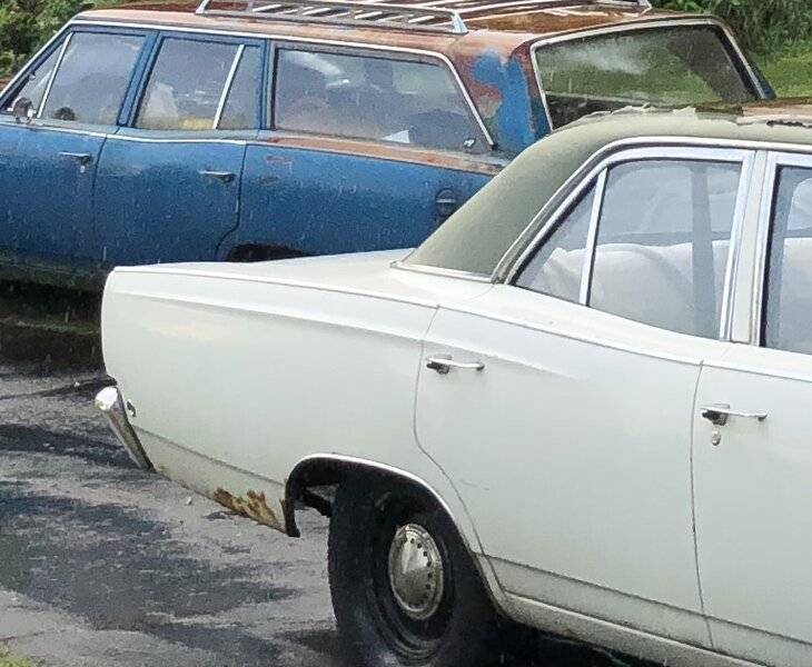

Here’s a bigger pic of my 4 door and wagon. Notice the body line above the door handle on the 4 door. Absent on the wagon. And obviously the Coronet 4 door is different.

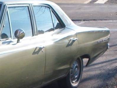

Here’s a ‘68 Coronet 4 door for comparison.

I measured both door cards at 30”. They look to be the same. And the door length is the same, checked on several places. The top as seen in my pics is longer on the wagon. I hope that helps you. :thumbsup:
