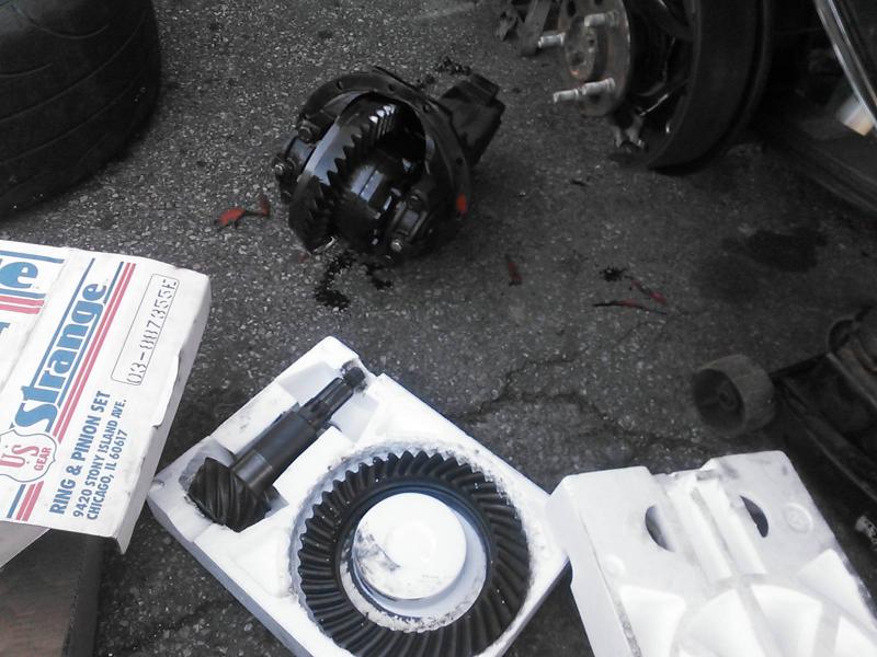

Since the tile for my job didn't make it to the job today, I decided to put my 4.10's back in. Up from the 3.55's that are there now. I want to see if this wakes her up off the line a little next week.

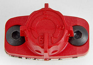

I thought I paid for the installation plan with them. What do think, I'm a grease monkey or something?
Its on the way!
You're gonna love those 4.10's. Glad you raced the old gearset first, love to hear your feedback. I'd love to get your feedback on the shocks as we'll.
I had the 4.10's when I first put the car on the road but never made it to the track with them. I put the 3.55's in because I was just cruising with the car. So now it's back to the 4.10's and to the track. Hopefully have the rear shocks in for next weekend.
did they charge you for it?
I just bought it from Jegs. It was only 8 bucks.

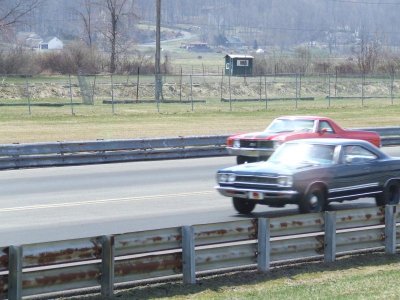

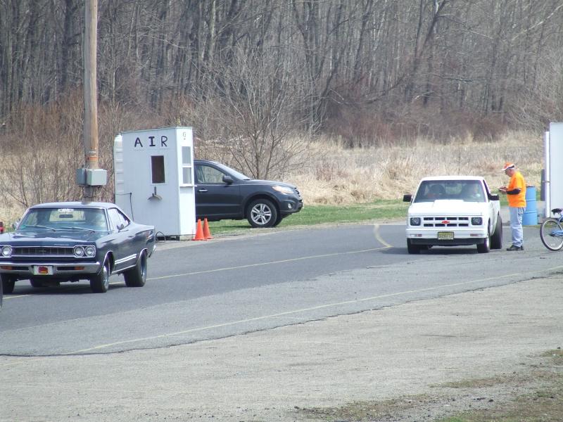

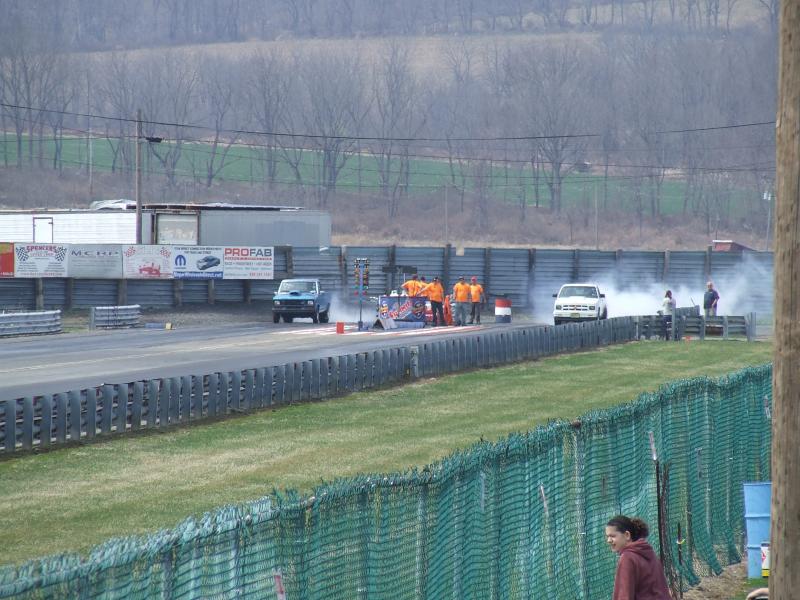

Here are some pictures.
Knocked off .12 off my et and had the same mph. with the 4.10's. Was hoping for a little more. I'm sure it's the driver. I got a little better every run, so I think I have a little more in it as it is. I definitely need a torque converter.
Got to 12.53 @ 111.36 from 12.65@ 111.75 with the 3.55's. It was also pretty warm out today compared to last week.

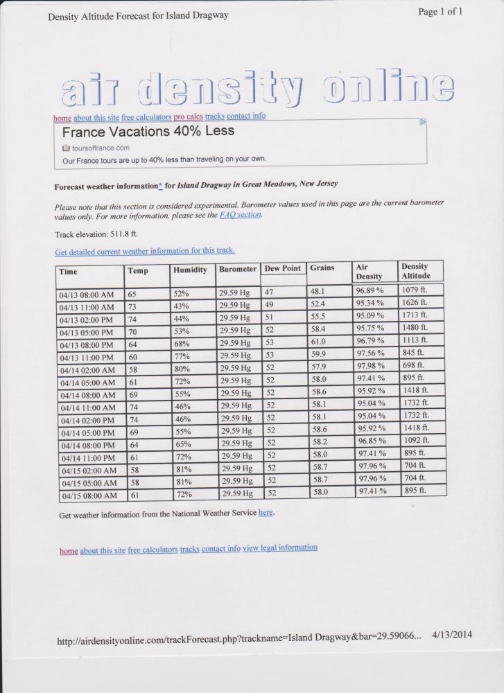

This will answer one part of Budnicks question.

Converter baby !! your going in the correct direction... a little better, need some wheel speed out of the hole, she'll wake up more... you'd have walked on that alleged 600hp ElCo way sooner... fly by him on the big end
saw a little weight transfer too, gotta' love when a plan "starts" to comes together, thanks for posting it & your et's/mph etc...
what you think I'm going to ask the temps & altitude ?? he he ha ha , yep it's a big part of racing, track conditions at run time... Have fun & Happy Moparing
Temp and altitude aren't so much a big part of my racing yet. Maybe when it rains!
