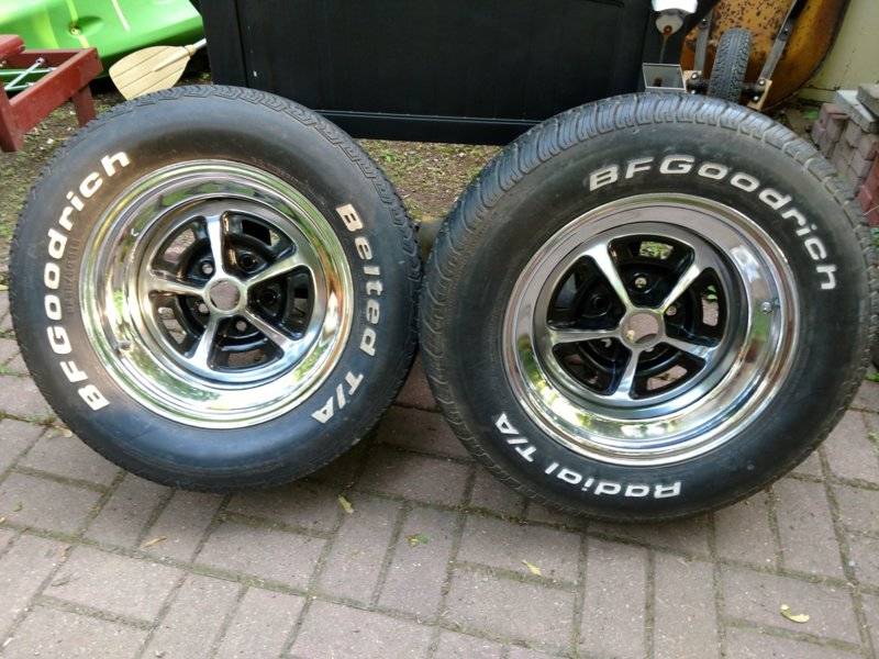

These are the rims I have on the front.
I had to remove about 1/8" from the hole where the center mounts.
The opening was not large enough for the retainer to drop in from the inside.
Perhaps it was just this set, but there is no way you would be able to mount the mopar centers.
I bought 15x7 ford stamped rims and had no problem mounting the generic centers tht accept what ever sticker you want.
I also have 14x6 and had no problem with those either.
