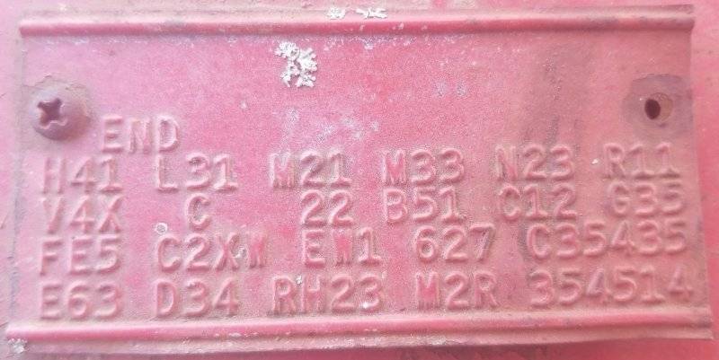

No rallye dash (see speedo) and it has the 400 CID engine. Just wondering if it really was a stock powerplant? Thank you.

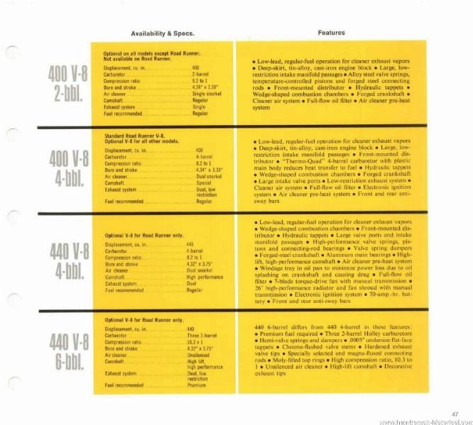

Scratching my head, I believe the 2-bbl 400 was available, while the 4-bbl was standard in the RR and optional in the Sebring Plus. That's from memory, not etched in stone.

That's interesting that when specifying the optional 4-bbl 400 CID it includes front and rear sway bars.

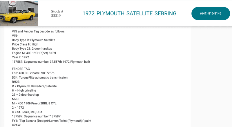

VIN for OP car is "M", which was the 2 barrel version.
The 4 barrel version WAS available as VIN code "P".

Typically the 400-2 and 400-4 were available in almost everything, kind of like the 383 was previously.
What typically wasn't available in anything other than R/T/Rallye, RR, Bee, was the 340.
...but in 74 the 360 4 barrel was available in almost anything.

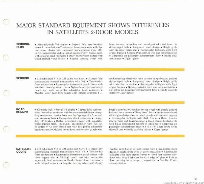

According to that, the 400-4 was available across the entire line.
