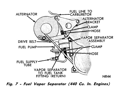

I now see where the fuel vapor canister mounted at the fuel pump has a line that runs back to the sending unit. The sending unit has a short nipple, alongside the supply, that serves as the return. Then a vapor line runs from the three nipple crankcase vent back to the canister in the wheel well. Somebody correct me if Im wrong. Thanks again

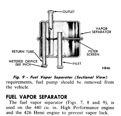

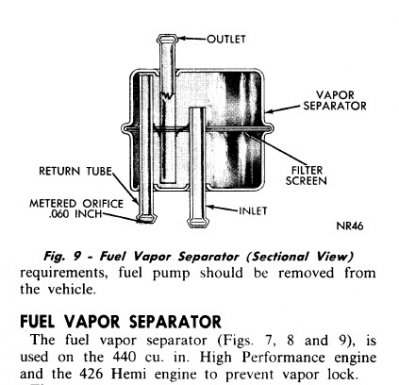

440 and 426 used this. They called it a vapor separator, which may be a misnomer. It allowed fuel in the line to the carb to drain back to the tank when the engine was shut off and the lines were heating up, avoiding vapor lock. But in reality, there was a constant bleed of fuel back to the tank whenever the pump was running.

The system being discussed ran from the vapor separator by the fuel pump back through a 1/4" line to a nipple on the sending unit.... The intent of this separator was to send any fuel vapor along with a metered amount of fuel back to the tank.... Some of the reproduction separators have either to large on an oriface or no oriface at all to control fuel returning to the tank... If you use a repo vapor separator it's a good idea to put a 065 Holley jet in the return line where it attaches to the separator...
