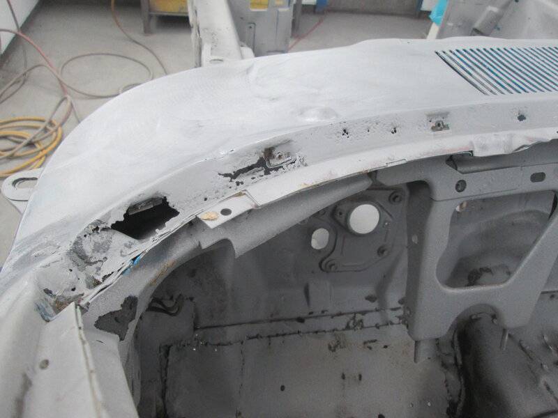

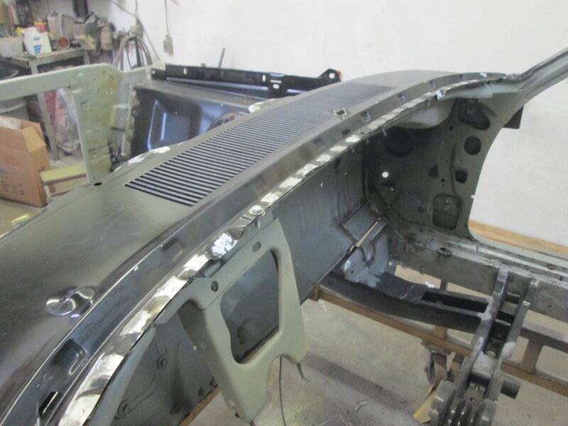

Whom ever installed the windshield didn't seal the gasket to the pinch weld, or if it's OE may have rotted out under the rubber. This was my top cowl upon car tear down.

Yep Gotta bite the bullit and do the work or stay away from water! Just that simple
