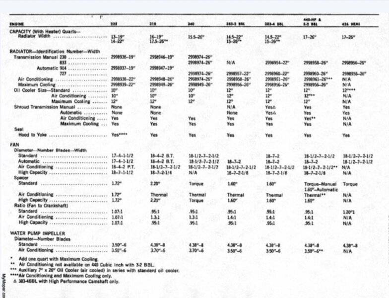

on a 440 what would cool better a 6 blade or 8 blade the 6 blade are a little wider. has non ac pulleys on there now. thanks

The OP asked about water pump, not cooling fan. The water pumps have different numbers of "vanes" which look like blades. Here's a chart for your reference. It's a bit blurry but it can be made out.
