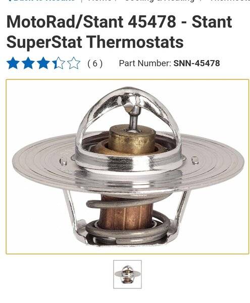

I appreciate the reply, and I understand the importance of a thermostat or "flow restriction" at least, as I've seen some use. I also know that I can check the Tstat in a pot of water heated up.
I am surprised that this particular Tstat doesn't have the factory drilled tiny hole in it, unless I'm missing seeing it, given that Stant thinks highly of it.
It's CHEAP, and that was a concern, but MAN they make it sound really good:bananadance:
I am NOT putting it back in, even though I know it's not the cause of the problem.
Check this description out:
Help your ride run more efficiently with Stant SuperStat thermostats. SuperStats feature a patented V-notch, non-linear valve design, which reduces cycling, bringing your vehicle to its proper operating temperature more quickly. This unique V-notch provides a small initial flow of coolant at start-up and, as your engine heats up, the V-notch opens wider to meter the proper amount of coolant into your vehicle's system. Other features include a high-flow venturi, a patented Weir valve, a larger actuator piston, a heavy-duty spring, and a thicker, high-strength burnished stainless steel flange. Stant SuperStat thermostats offer reduced oil consumption and emissions, improved fuel economy, and a prolonged engine life for your vehicle.
