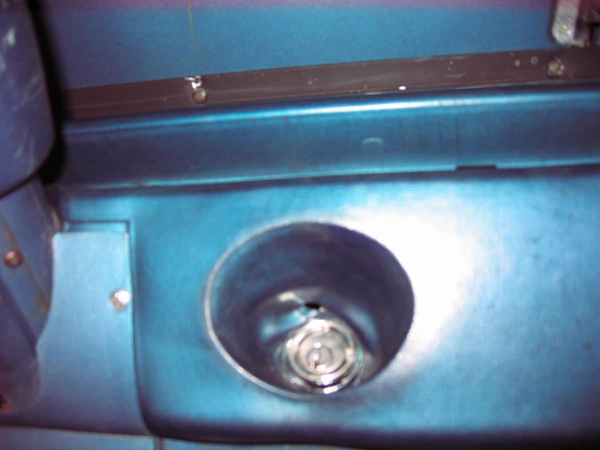

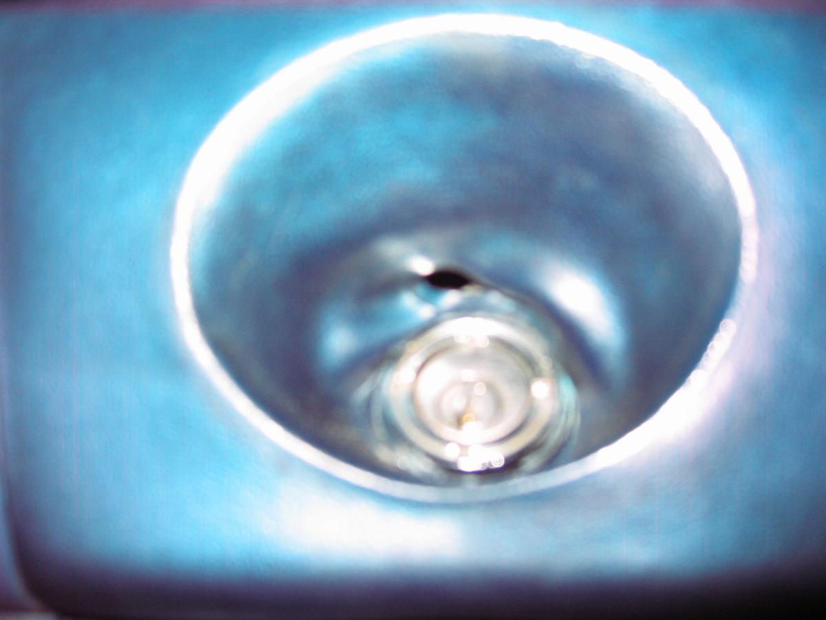

Does your ignition switch have a bulb that lights it up? If it dont, that is probably where it goes....It should have a blue cover on it, and it mounts in the dash and shines through a small hole for the ignition switch.....check ebay for your flasher.
Hot Damn!!! Thanks pr that was it!!!: :sSig_wootwoot: it looks like my lower dash panel must have spit out dat little bulb!!! the ignition hole (huh-huh hole) is kinda warped and it isn't straight. the bulb's glass was intact, but it was burnt out...i have another dash panel in da attic i'm guna have to refurbish and then put that sucker in! pr any online stores you know about? I looked on fee-bay and only found da one for thirty bucks and not even sure that it is da right one :mad_6:
