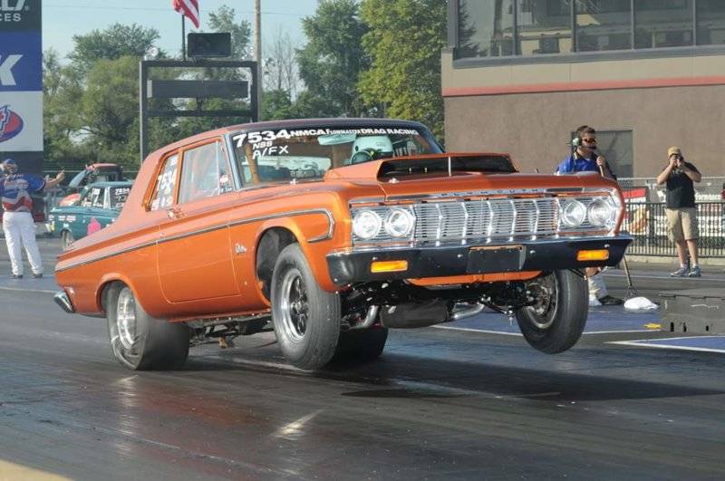

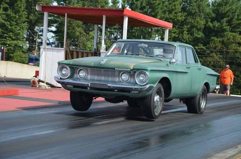

Advertised weights are just that advertised. My sons 62 4 door weighs just over 3500 w/o driver. 360, manual steering, manual aluminum master, factory FMJ disc, Dana, fiberglass leaf springs, Cal Tracks, 6 point roll bar, aluminum radiator, aluminum intake, 75 mm turbo, 4" single exhaust. Some of these add a little weight, others are lighter than stock. All other parts on the car would be factory weight. Most street trim B Bodys are 3500-3700 w/o driver. Not that you can't get lighter if you are creative. My 64 Belvedere is all steel except the hood. It has a Mega block, fire system, full interior except back seat, Dana. It weighs 3120 empty.
