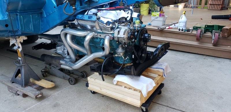

I built a cheap cart with a furniture dolly from Harbor Freight and a bunch of cut-up
2 X 6's to put mine in. Installed it in 30 minutes by myself. No problem.

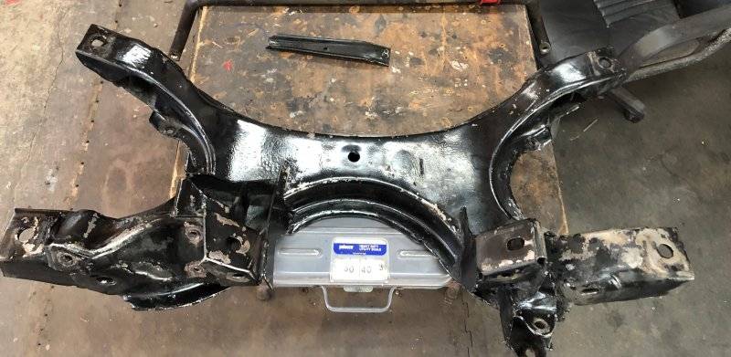

Zyzzyx, those pictures are very helpful. Thanks. I am hoping to reinstall the k member with the suspension and steering parts on it, but maybe it would be better to just get the engine and trans up in there first.
670 lbs for the engine, 160 lbs for the transmission, say 55 lbs for the k frame, another 75 lbs each side for the uca, lca, spindle, brake etc, you're at 1,035 lbs. I'm going by the feel of the k frame and suspension/brake components from when I did mine but I reckon I would be close.
