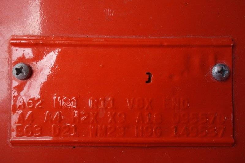

This fender tag on a 1969 Super Bee looks fake to me. I am not an expert, but it looks like it is missing a lot of numbers and other information.
They also don't always have a ton of codes on them. Depends on how optioned the car was.
a bare bones silver 4 spd car with a black stripe
It depends on what was coded at a particular plant. It could be a highly optioned car but with few codes on the tag.
Post 68 Lynch Road tags carry very few “option” codes.
The seller claims the VIN is WM21H9GXXXX. The tag has WM23 on it so I an I wrong to assume that the VIN is not for this tag?
At least the last eight digits of the V.I.N. should be stamped on the rad support and the trunk rail. If it matches the fender tag then it will be the tag for the car, unless it is a phony tag, which it doesn't look like. If the car has roll down quarter windows then it is 23. Push out windows is a 21.
WM21:
Dodge Coronet,Charger
Medium, Super Bee
2 Door Coupe
H90: 383 330HP OR 335HP 1-4BBL 8 CYL
1969
Unknown
149537: Sequence number
E63: 383 cid 4 barrel V8 H.P. 335hp
D21: 4 Speed Manual Transmission
A4: Silver Metallic Exterior Color
A4: Trim - Basic, Vinyl Split Bench Seat, Unknown Color
H2X: Unknown Int. Door Frames
X9: Build Date: 9
A18: Order number
A62: Unknown Top Color
M21: Roof drip rail moldings
R11: Radio Solid State AM (2 Watts)
V8X: Tranverse Stripes, Black
END: End of Sales Codes
Yeah, the car is listed as a ram air with a 440 which cannot be original to the car. The car is a post car, but the fender tag claims it is a hardtop. Unless I am mistaken, the tag is not original to the car.
