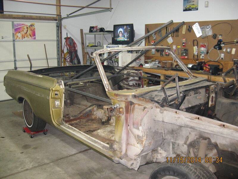

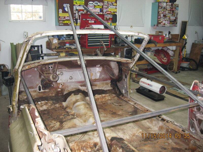

I’m doing a 64 Polara convertible. I welded 1 inch square stock pieces on the inside of where the doors are, running front to back. I then tied another piece into these 2 pieces going from one side of the car to the other, just in front of the door opening where the rear of the door would be.
Lastly, I welded two more pieces to that cross piece that run up to the top of the windshield frame. I don’t have pics on the device I’m using right now to post this, but I can post pics tomorrow if you think this the way you want to go....

Here's a couple of pics on how I braced up my 64 vert with 1 inch square stock....
