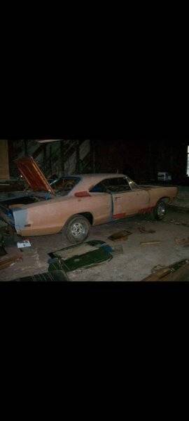

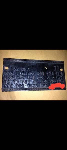

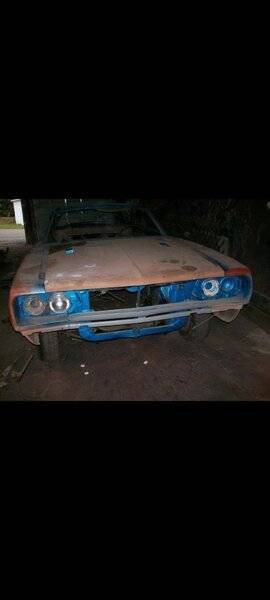

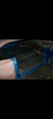

Bought this car, zero rust. Id like to put this car back to origional. Color and all. I just looking for a pic if anyone has one thats showing what this car would have looked like from factory. Heres the tag....

That's a bronze metallic with the similar color interior so it will be cery sharp when done. Not going to run i to another one at the shows. What did you have to give for it?
Might need some help decoding the tag, theres some codes on it that i simply cannot figure out or find
I see N96... That’s always great!
D21 and A62 are sweet as well!
N96=Ramcharger Fresh Air Hood
D21= 18 Spline 4 speed, also Dana required.
A62=Rallye Dash (Charger).
N85=Tach.
A34=4:10 Dana.
Probably Power Disk Brakes as well... B51,A34.
The last 2 rows i dont know where to get that info, or im looking at the wrong spot in my books
bottom row middle,,,E86=440 HP,,,D21 = four speed,,,,W=coronet,S is special 23= hardtop L is 440 magnum, 9 is the year, G is plant.If my eyes are not failing me.
It’s a ‘69 Coronet R/T with all the right street fighting options. Was certainly a bad *** when it was new.
Im really excited about this car. 3rd row down on the tag is all i have left to decode now. Thanks guys. Only thing is i just started the 69 bee project. Ill have to finish it first. Then this car, ill def be putting back the way it came from factory..
