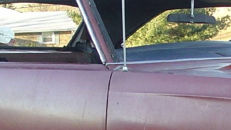

This car came with no hole for a radio antenna in the "normal" place at all. This fender never had one, even though the car did originally come with a radio.
What this fender DID have was a little 5/8" hole way up in the corner of the fender right in front of the door.
Here's a pic of the car as it was dragged out of a field a decade ago:
We're talking WAY up in the corner of the fender - and was evident it had been punched, not drilled, like with a Whitney punch if anyone remembers those.
Well, a normal factory correct antenna wasn't gonna fit, obviously. Note the cheesy old antenna the car had on it back then.

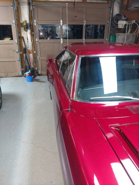

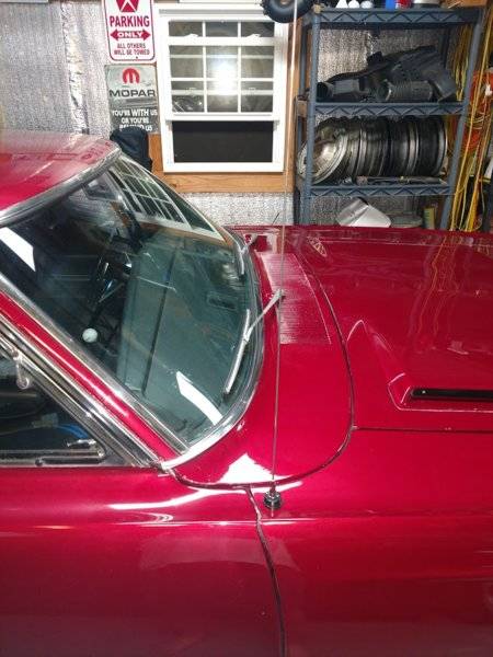

This evening, I go out to the garage to see if this thing has a chance of working and thinking "no way in hell" - but the threaded part of the antenna squeeked through the hole.
Ok, but there's no way there's enough room for the door's full swing in there if the antenna is in place, right?
The door cleared.
Barely.
A little grinding on the appropriate base adapter, finding a rubber gasket, test fitting enough to see if the nut could get a thread - all passed.
Ok, but there's no way I can snake my arm through the door jamb opening back inside the fender and get the antenna lead through the hole in the kick panel, right?
Nope, not this arm.
Then my wife said "gimme" - and then proceeded to do just that.
Ok, antenna is actually installed and tight and plugged in (thanks again, my dear wife!), but no way this obviously Chinese cheap *** antenna will jive with my newly-fetched radio, right?
Well...
Even in my metal sided and roofed garage after dark, it was picking up stations from faraway places like Chicago and NYC thanks to signal skip that happens at night.
The radio works. lights - dial - tuning and all.
The 50+ year old dash speaker works (!!!)
The antenna fits.
Most importantly of all, a silly little project is over on the GTX (and successful!) and I can't stop grinning about it.
