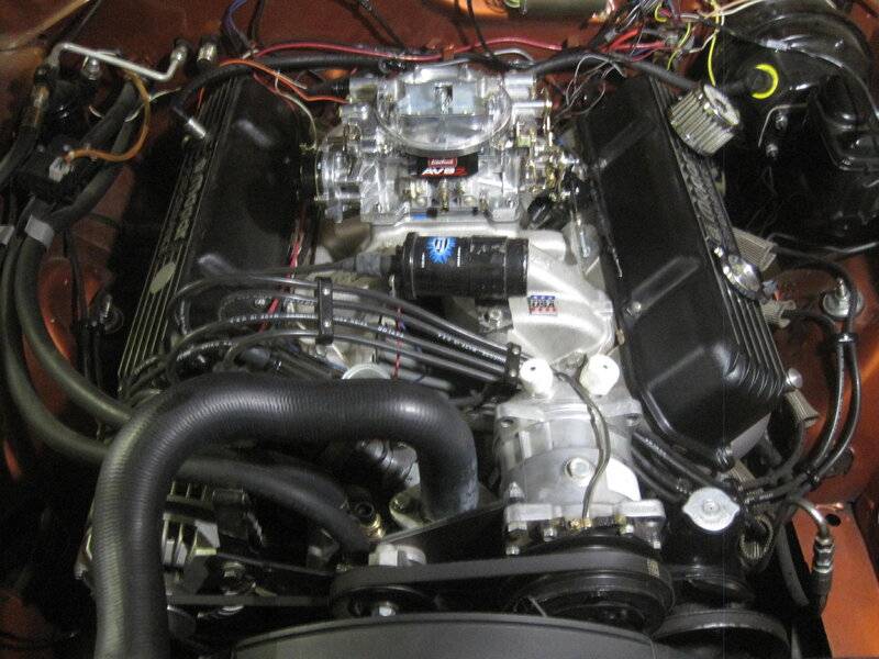

Once I finally made the decision to leave the EFI world, I needed a carb. I went with the Edelbrock AVS2 800 cfm w/electric choke, model #1913, along with an Eddy carb tuning kit. My Dart has an Eddy 750, model 1407 and I've driven that car down to LA for Spring Fling, up past 6000' to go camping in the Sierras, and everywhere in between. So it was an easy decision to go with the AVS2.

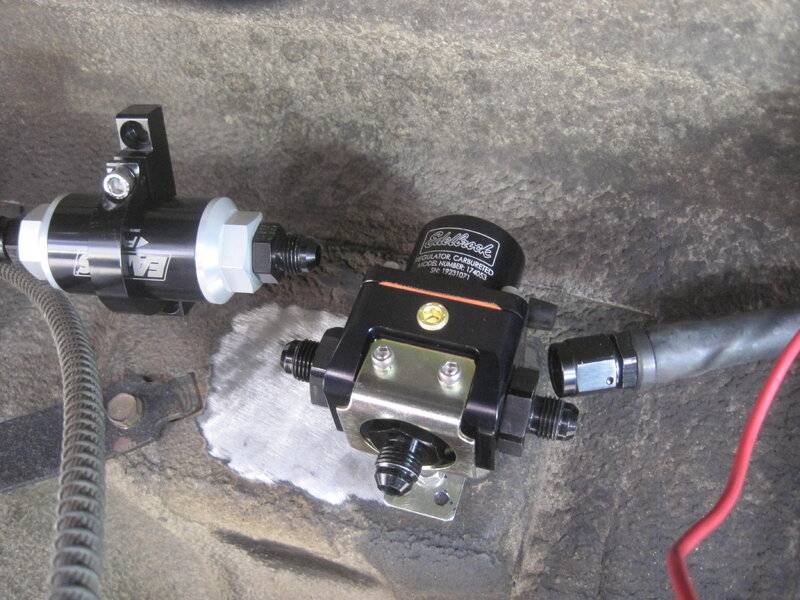

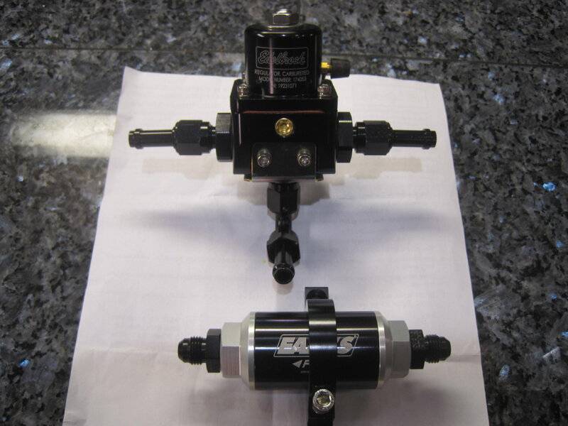

Converting from EFI to carb is much easier than the other way, you just need a carb, regulator, and new fuel filter. I'm retaining the Tanks Inc. pump but the LS style filter/regulator has to go because its calibrated at 58 psi.
I got an Eddy fuel regulator to knock the pressure down to 6.5 psi, and an Earl's 40 micron inline filter.
Fortunately I was able to reuse the fuel tank outlet hose, the homerun hose up to the engine compartment, and the return hose back to the tank, all without having to modify. The only new line I had to build was between the filter and the regulator. This is the mock up stage; the new regulator mounted in place of the original. The red wire is the power for the electric fuel pump.
I've thought about an EFI unit for some time, and figured it was an eventuality (much like a Gear Vendors unit). In the meantime, I researched various carbs; sought advice from the clan here on FBBO; talked with local guys. After all that I plopped down the dough for a new AVS2 also. It just went on this week, so today is the day I'll fire it up.
I appreciate hearing of your experience with EFI. Maybe it's best to stay with the old-school carb setup. I went with the 650 version of the AVS2, and I suspect I'll be very happy with my choice.

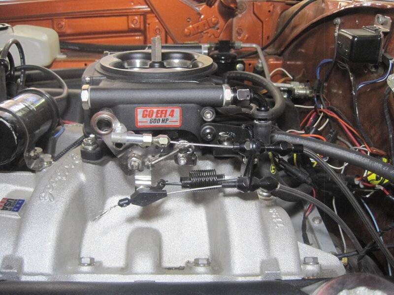

The FiTech TB, ready to be removed.

Just checking in on this picture....I cannot see clearly enough if you have a dedicated return line going back to the fuel tank. Initially with the Sniper, I tried using a Holley Filter/Return unit and it was not successful (pictured below)
The fuel MUST flow through the Sniper (and presumably all TBI units) to give an accurate flow. The flow of fuel also helps to maintain a cooling effect. "Dead-heading" the pressure and bypassing back to the tank will give unreliable pressure and volume at the TBI.
Now, just in case you do have the correct flow and return lines installed....this advice might be useful to anyone else contemplating a shortcut. :)
