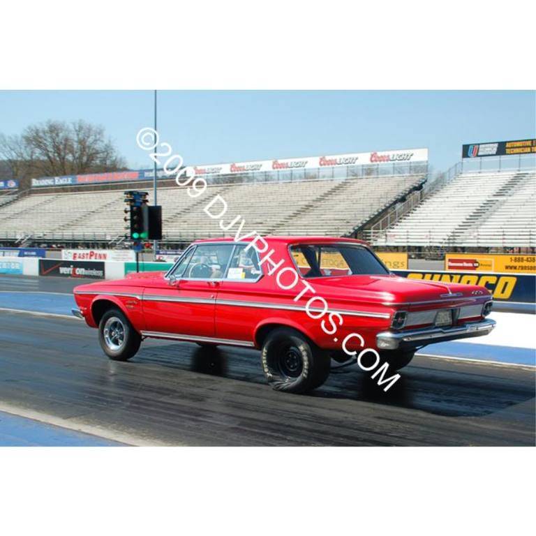

Went racing with my 63 this weekend.

I had a good time as my son and I drove the 90 mile round trip to the track saturday for a T & T. I was very pleased my car ran 11.55 @ 115 with a best ever 60 at this track of 1.59 in the very hot and humid heat. Considering my best is an 11.52 on a very cool Oct day this makes me think it has easy 11.40's in cooler air. I cant wait until it cools down. My son ran 11.60's as we always run very close.
For those who dont know my combo its a stock body and suspension 63 Sport Fury with SS springs. Has a basic mild 440 build as it is stock bottom end with .030 over KB quench dome pistons (446) and I run 10.0 comp with 906 heads that I ported. I use the MP .557 solid cam with Isky iron rockers. Holley Street Dominator and a basic 850 DP. Hedman 1-3/4 headers with 3" pipes as it runs 92 pump and I run it thru the pipes. 727 with Dynamic 9.5 converter and 4.30's with a 30 x 9 radial hoosier slick. I have a 6 point roll bar and frame connectors to stiffen it up. Its a real street car as I drive it everywhere including to the track. Ron
Hey 383 man, looks real good and 60foot is great. It looks like it hooks very good with the 9 x 30 slicks. Dantrap
