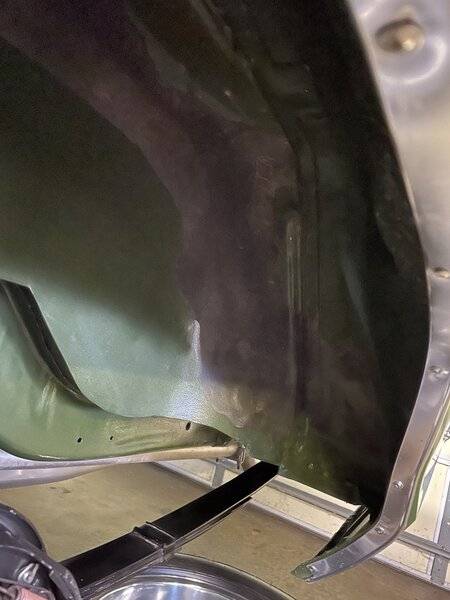

I’m wondering what to paint the rear fender wells. Originally painted as rest of car (green). I’m wondering about a black undercoating similar to factory. Does anyone know of a quality black coating?

The Resto Rick product is the closest you can get to the factory finish. It takes multiple coats to get the texture to the OEM look. I use 2 gallons to do the 4 wheel wells and overspray details.
Application Tip: Take a picture of the area after application with your flash on. The paint will reflect through if the coverage is not adequate. Repeat until desired coverage is attained.
