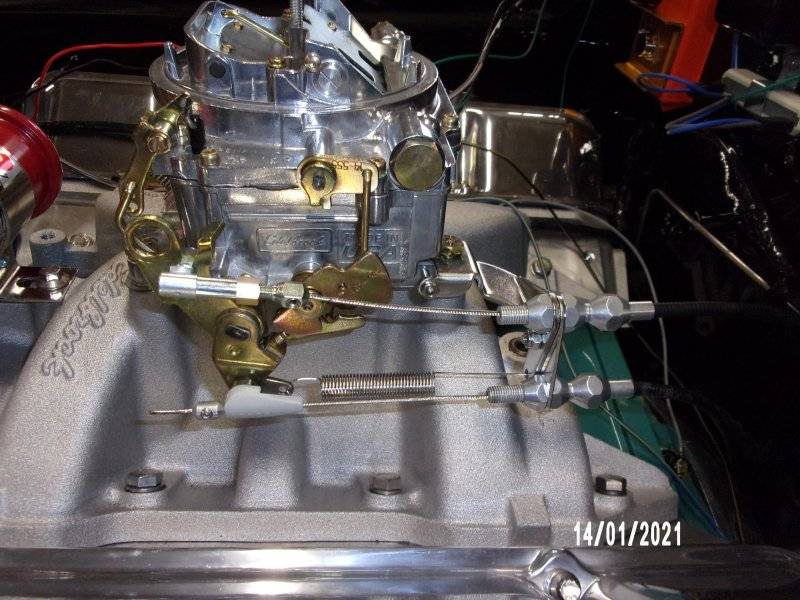

Lokar throttle and kickdown. ruffcut

Lokar! Same type as in #3!
installed easily and been there ever since!

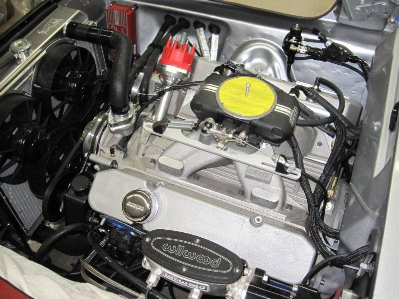

Lokar cable with Jegs bracket and a angle cable mount I fabbed.

I really can’t speak on other ones. I went from original setup to the lokar. Been great since! Here’s directions for kick down.

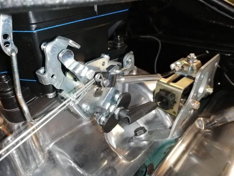

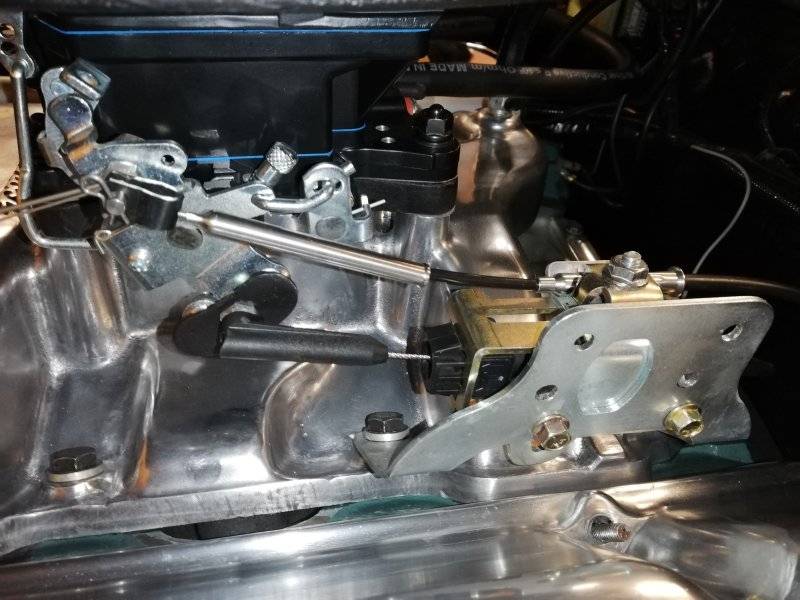

Tried Lokar, Bouch, etc but never sat right.
Ended up with a combo of Bouch, Mancini and original throttle cable that rocks.
Interesting! I have that bracket you show on the right and my current setup is Bouchillon. I may have to give that a try.
I got the tall Mancini bracket and bent/drilled to fit.
Then drilled two extra holes for the lowest position for the throttle cable clamp part.
Its adjustable both in height and angle.
